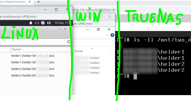

I then mount the samba share located on my TrueNas using one of the AD DC users DOMAIN/user1 and can create a file.
But the ownership for the files is not what I expect them to be, nor reported in a consistent manner:

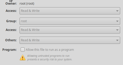

Via the client GUI root owns the file (I logged in as local, not root):

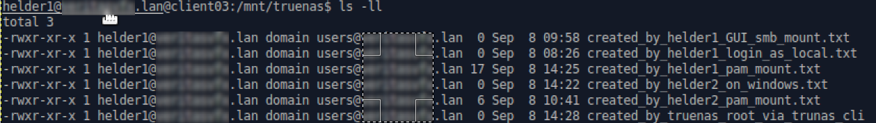

Via CLI, navigating to the mount point using gvfs the file is owned by local:

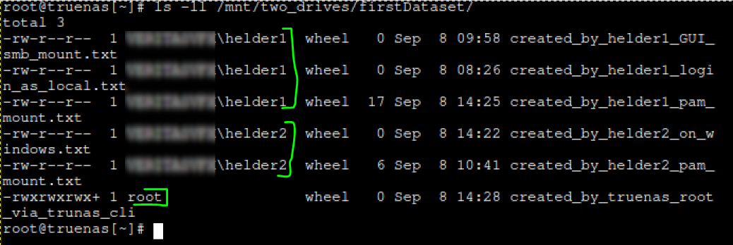

Then Shell on the TrueNas machine itself, itis owned by DOMAIN/user1:

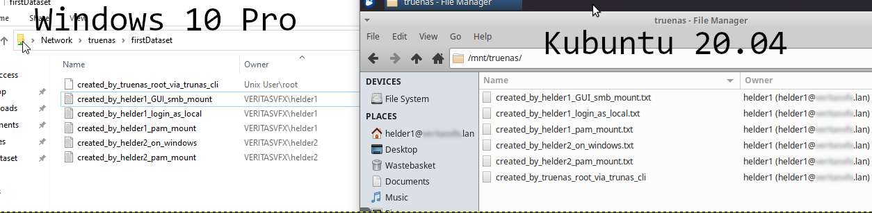

I went ahead and added automount via pam whenever a domain user logs in. but i still have some issues.The GUI still reports the ownership as being the user that is logged in at the moment, not the one who created the file, on windows it works straight away.
Perhaps linux is reporting the owner of the mount,rather than the owner of the file as per truenas?

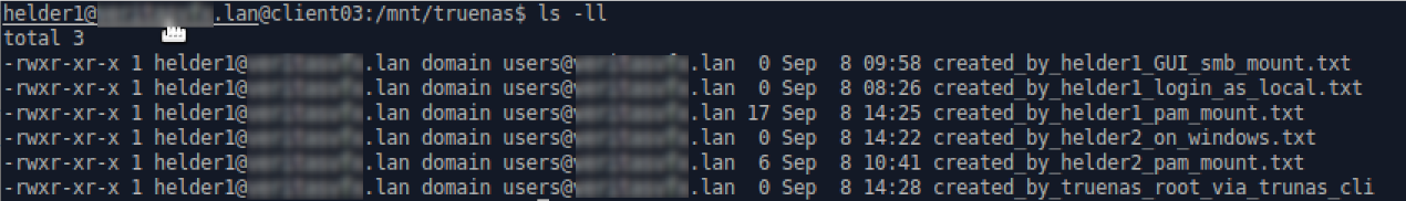

The CLI on Kubuntu at least matches the GUI now:
And on Truenas it matches what i was seeing on Windows:
