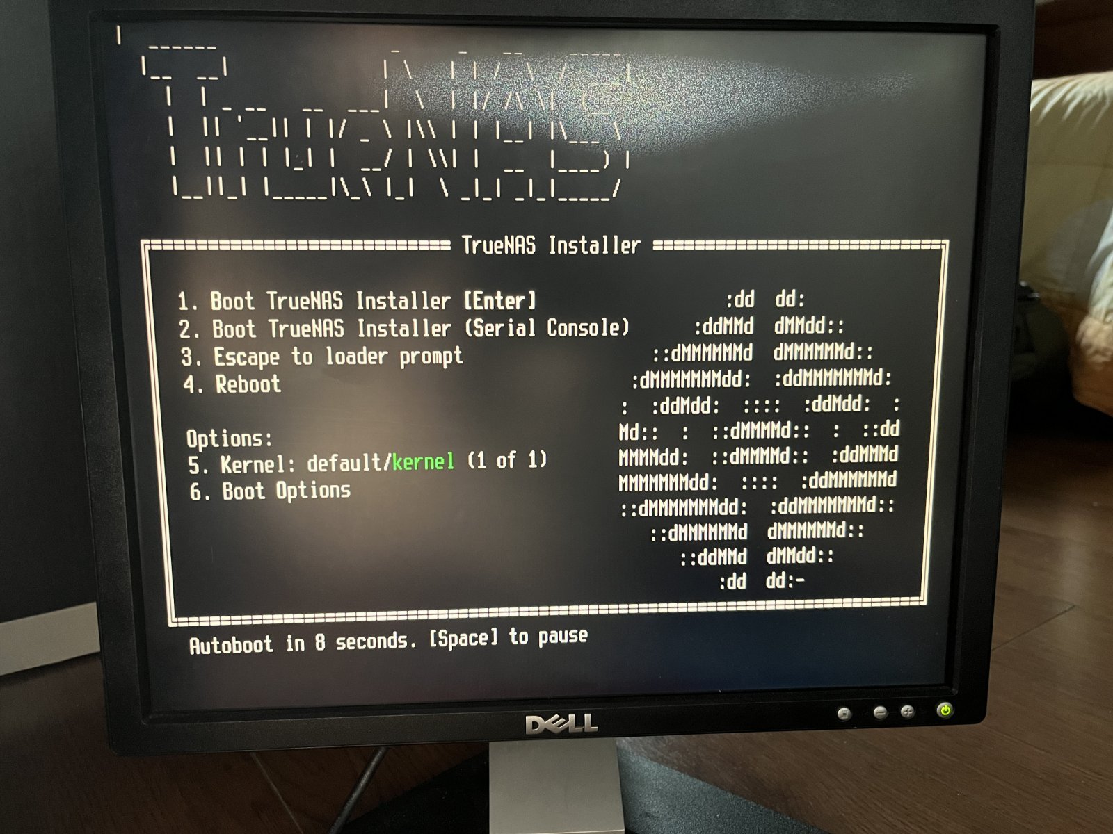

I am getting very frustrated. I have tried downloading the current TrueNAS Core iso install file on my Intel MacBook Pro, but whether I use Safari or Chrome the download stops after downloading somewhere between 5% and 20%. I am in Thailand using 3BB as my internet provider with speeds of 1TB down and 500MB up.

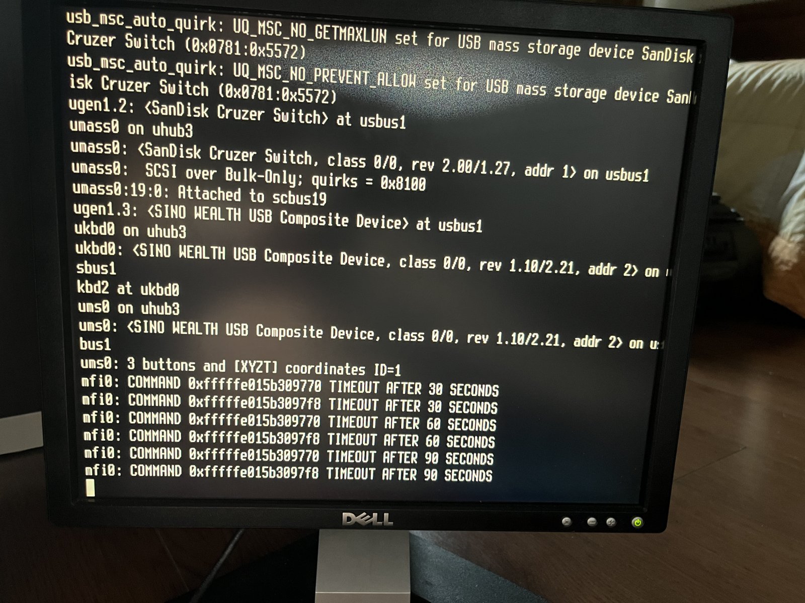

I have also tried downloading on my Acer S3 Aspire which is now installed with Unbuntu 22.04. This did manage to complete the download very slowly, which I then copied across to my MacBook to use Balena Etcher to write it to a SanDisk USB stick. Unfortunately when I booted on my new installation the install menu did not appear after selecting option 1 on the grub menu. See attached screen captures.
it has been a very frustrating day. Does anyone know of another host I can use to download the file?

Sorry, I forgot to add the screenshots

Hi, sorry for the delay in responding to you. I had been getting very frustrated with the build, I needed to stand down for a few days.
I managed to get a few TrueNas Core iso downloaded and I did check the sha-256 to make sure the files weren't corrupt. Each time I try the install I get the same result as shown in the two images above.
As I said, I tried a Ubuntu Desktop 22.04 install which succeeded without issue.
I then thought I would try a TrueNAS Scale install. Again a successful installation without any issues
I really wanted to install TrueNAS Core as that is what I have got currently installed on my old HP Microserver Gen8. I was wanting to bring across my existing pools which contain my Plex data and my Plugins and Jails on a SSD pool. However, looking at the apps available on Scale, I am not adverse to upgrading to Scale.
One thing I have discovered with my build is the IPMI module on the ASRock Rack motherboard does not appear to be working properly. The server management section of the Bios reports that the BMC self test status is FAILED. I am wondering whether the TrueNAS Core install would pickup on this and perhaps that is why the install is failing . IO am contacting the company that supplied my with the motherboard for their support.

What sort of controller is in that server? FreeBSD trying to use the mfi driver hints it is not well supported by TrueNAS, anyway. Generally you want an HBA using mpt.
