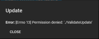

Hello,
I am currently running with TrueNAS-13.0-U1.1.

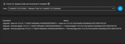

I would like to upgrade to the latest stable version.

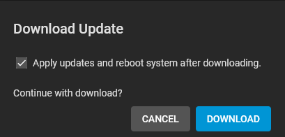

After slect "Download updates", and saved current configuration,
Here is the error:
What could I do?
Thank you!

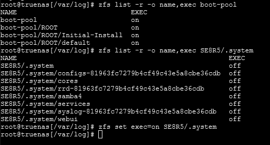

Edit:
Sorry, I should have done some research before posting...
Without EXEC rights on the .system directory, it won't work. So I added the permission with the command shown in the screenshot.
But still one question:
The boot pool is supposed to be on a dedicated SSD, while the SE8R5 pool is my data pool with 3 HDD in RAID5.
Why is the .system on SE8R5 and not on the other pool?
I guess the problem is between the keyboard and the chair, but I don't remember what I've done :grin:

Did you manually set the .system dataset to Exec=off? There's no way to do it in the GUI.
Oct 22, 2019
3,641
What does this reveal:
zfs get exec SE8R5
zfs get exec SE8R5/.system
