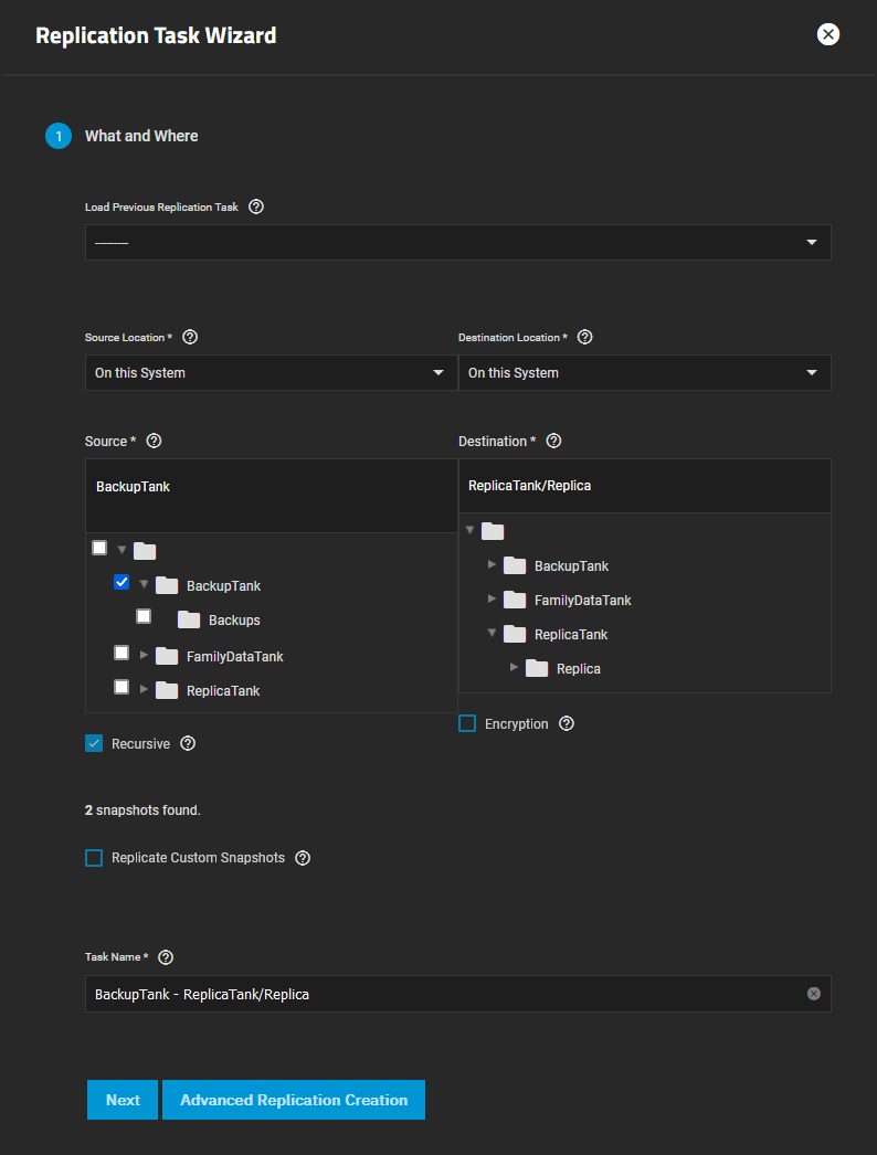

I have a fresh install of TrueNAS-SCALE-22.12.1 on commodity hardware (system specs in signature) and a bare-bones configuration of TrueNAS Scale. No VMs, just 4 pools (including the boot pool). All of the datasets were created as SMB compatible except for the boot pool. I used the basic wizard to make the replication tasks with the recursive option checked of which I have attached a screenshot. I'm also a novice to TrueNAS and Linux in general.
