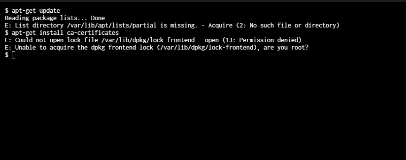

I've installed Duplicati from the truecharts catalog. Trying to set up a backup to Backblaze B2 I get a trust failure. Buckets an app permissions are set up correctly on B2. The problem and solution is described in this post and the workaround is to delete a certain certificate. Using the shell from the gui I try to enter the commands but It's not working (see picture). Apparently I'm not root. How can I issue commands as root??

General update (possibly just documentation for myself):
I've tried to do the more direct-route and actually running the commands in the container specified in the Duplicati forum post. Specifically, I sshed to the TrueNAS SCALE machine, then ran:
$ # Get docker container id
$ sudo k3s kubectl describe pod --namespace ix-duplicati
Containers:
  duplicati:
    Container ID:   docker://202c3bf15b88ae256822fc968212fa0a85988695a9c17761e74a2f74359ad88f
$ #Next log into the container with the root user
$ sudo docker exec -t -i -u root 202c3bf15b88ae256822fc968212fa0a85988695a9c17761e74a2f74359ad88f /bin/bash.
root@duplicati-fccb6db76-bw7k7:/$ # Now in container
Unfortunately, the filesystem for the container is read-only, so none of the commands work though. I'm not sure why this is the case, or if there's anything that can be done about it.
If anyone knows how to make the container file-system writable, please let me know.
