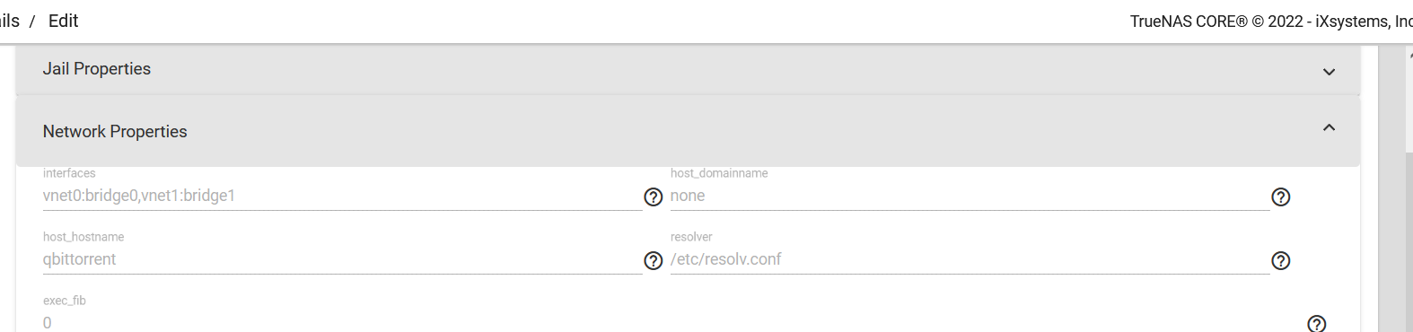

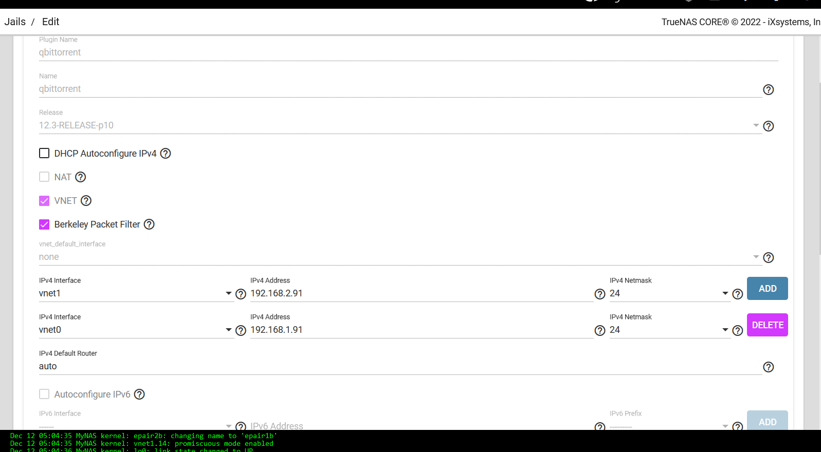

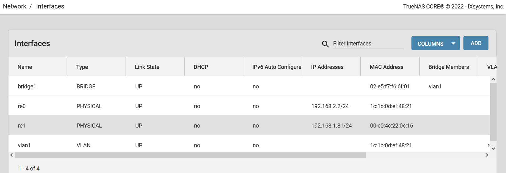

I tried all possible combinations but it doesn't work. I have some plugins that must work on both network interfaces that I have in Truenas (the main ones: re0 and re1). How is it possible to enable both for a specific plugin?

Roughly you need to:
  • reboot your NAS with all jails turned off
  • create an interface of type bridge named bridge0 with re0 as a member interface (Network > Interfaces > Add)
  • create an interface of type bridge named bridge1 with re1 as a member interface
  • test and save
  • disable hardware offloading for both your physical interfaces
  • if there is an IP address on re0 and/or re1, delete it and move it to the respective bridge interface instead
  • test and save
Then for your jails configure:
  • vnet_default_interface: none
  • interfaces: vnet0:bridge0,vnet1:bridge1
  • configure IP addresses for both interfaces
Done.
HTH,
Patrick

In the screenshot there appears to be also be a VLAN interface. Is that correct? If so, adjust @Patrick M. Hausen's instructions slightly - vlan1 should be the member of the bridge, not re0.
But I ask again about the goal. What's the reason for having multiple interfaces?
If it's an attempt to optimize things, I would encourage you to start more simply. Multihoming adds a bunch of complexity and some risk.
