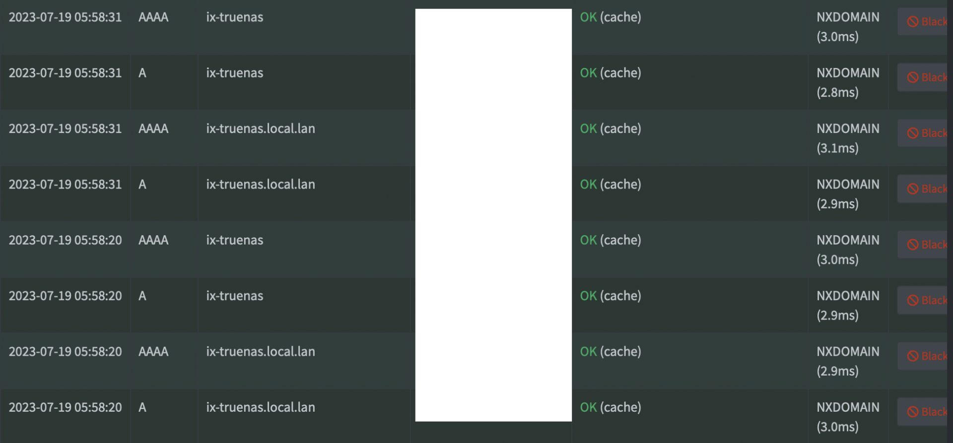

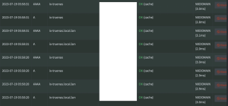

Just installed Truenas scale 22.12.3.2.
pi-hole is reporting dns requests to ix-truenas every 10 seconds, easily becoming the top dns client in network. Misconfiguration?
I did see this post, but it was related to Core from 2020.

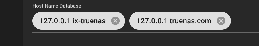

@blademan
It's Kubernetics, you have to add ix-truenas to your hostname database, i have 2 rules 127.0.0.1 ix-truenas and 127.0.0.1 truenas.com.
Do it from the web-ui not shell, network-global configuration-host name database.
the spam will stop

Thanks @dgrigo I observed 6 request per minute until 10AM yesterday. Then it decreased to 3 requests per minute until 23:10. Then it ramped up to 12 requests per minute, and hasn’t dropped since then. I added the hostname addresses around 21:00. All times PST.

I was able to identify a few older posts on Reddit, and have added this to the Global Configuration:
After entering that, I'm still seeing the similar level of DNS query volume to domains update.freenas.org, update.ixsystems.com, update-master.ixsystems.com
