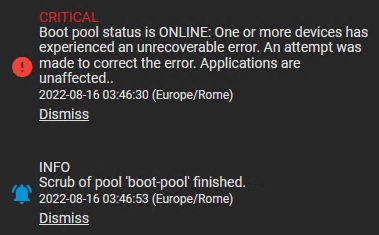

New boot installation on new ssd
Same error
different USB port, nothing change.
status check
pool: boot-pool
state: ONLINE
status: One or more devices has experienced an unrecoverable error. An
attempt was made to correct the error. Applications are unaffected.
see: https://openzfs.github.io/openzfs-docs/msg/ZFS-8000-9P
scan: scrub repaired 0B in 00:01:53 with 0 errors on Tue Aug 16 03:46:53 2022
config:
NAME STATE READ WRITE CKSUM
boot-pool ONLINE 0 0 0
da4p2 ONLINE 1 0 2
errors: No known data errors
Any suggest ??

homer27081990
Aug 9, 2022
321
OMG
Same error
status check
pool: boot-pool
state: ONLINE
config:
da4p2 ONLINE 1 0 2
Any suggest ??
Either your entire USB controller loses power or something, or your external case (or cable) have a problem.
