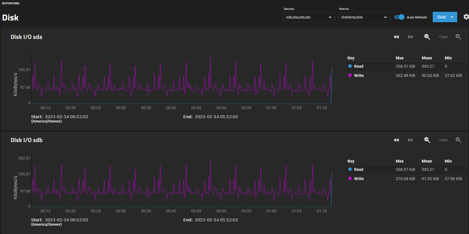

Yesterday installed TrueNAS Scale (latest version) on brand new clean disks. System installed onto NVMe, and pool created on 4 HDDs. Also created 2 users, but that is all I did beyond the installation. GUI showed disk temps right after install, but after shutdown and restart disk temps are not available anymore. I have no shares created, no containers, all services turned off.
Also, and most worrisome, is constant disk I/O to pool disks, and I do mean constant, see plot below, that actually goes back for a full 24 hrs. There is absolutely no data on the pool disks beyond teh creation of a data-set, but have not uploaded any files to it. There are no other devices on the network overnight (turned off the computer accessing the GUI), so the server is not responding to any net traffic. There are also no READS, it is all WRITES. There is no outgoing network traffic out of the NAS, judging by the activity light on the RJ-45 jack on the switch.

...I should add, the disk activity is the same for all 4 HDDs, two are shown in the pic above, but the other two are identical. I have a RAIDz.

It's your System Dataset + logging.
You can move your system dataset to your boot-pool instead.
Look under your System settings.

There are some options throughout to make the log less "chatty".
But the System Dataset will always be a source of constant writing.
TrueNAS, Core or SCALE, are pure ZFS solutions. There is no TrueNAS without ZFS.
However, now that I think about it, you might be witnessing writes to the System Dataset + logging + K3s/ix-application, since you are on SCALE.

@zook007 has a constant write pattern of 100KB/sec.
