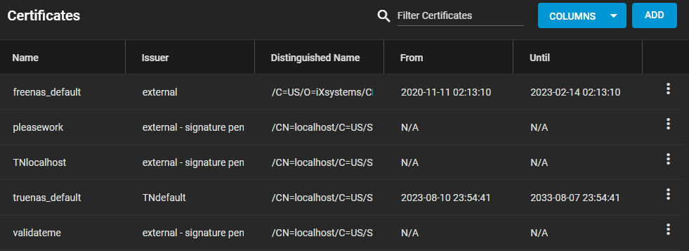

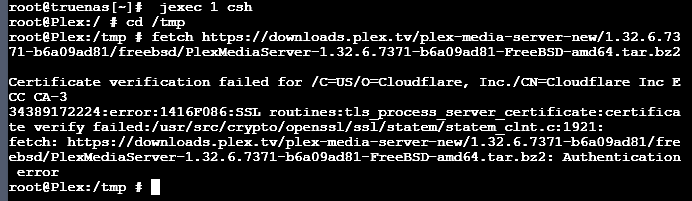

hello i got an error when trying to manually update my plex like I usually do. Any help is resolving this issue would be greatly appreciated. Tried making a new cert, tried rebooting the machine.
Version:
TrueNAS-13.0-U5.3
trying to manually update plex and getting and error photo attached with error details

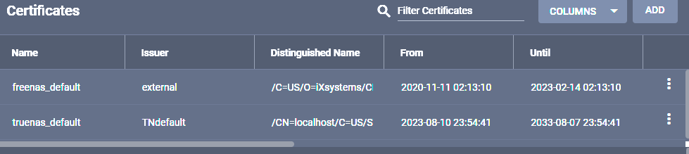

I then noticed my cert if out of date and made a new one however I am unable to delete the old one

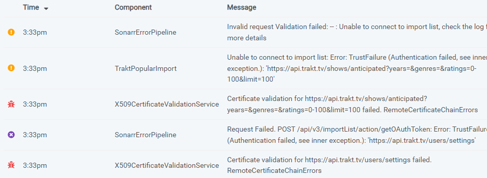

Still working on resolving this issue. I noticed a few other things I have running are no longer connecting to external sites.

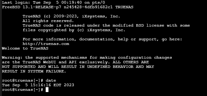

From what I can see here, it would make much more sense to me if you were having trouble with the validation of the certificate for plex.tv, not for your own server's certificate.
The likely cause of that (not having any other relevant information to go from) is a time discrepancy on your system, causing the certificate validation to be impossible.
Check your BIOS battery and the system time and timezone.

Agreed. The problem that's going on here has nothing to do with the certificate on your NAS, so creating a new cert (and deleting the old one) will do nothing to solve it. The reason you're having trouble deleting the old cert is that something (likely the web GUI) is still using it; you can change that in Settings -> General IIRC. But again, that won't do anything in terms of addressing your problem connecting to plex.tv.

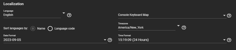

As @sretalla says, the most common reason we see here for cert validation failures is that your system clock is off. You can determine this by running the date command. If it is incorrect, correct it in the BIOS settings (being sure to set the time to the current UTC time) and you should be set.

I can try to supply any information requested to help resolve the issue I am having.
date checked and appears to be fine in bios, shell with date cmd and looks good in the gui

The whole thing has just been chaos following other guides and suggested from other people. I tried making new certificates and setting the new ones to the default in the gui, but none of the ones I made fix the errors i am having.
Since that expired a few issues I have would be connecting to plex.tv to get the update file
sonarr no longer connects to trakt lists at all even though it shows its connected in the trakt dashboard and was working prior to the cert expiration

The following link may have fixed my sonarr cert issues that popped up when my cert expired. Currently waiting on the system to reboot.
I tried to follow the same process for plex but wasn't able to import the cert as it said it was unable to sync

new "truenas_default" and old cert "freenas_default"
This error was able to be fixed by running this command
pkg install ca_root_nss
