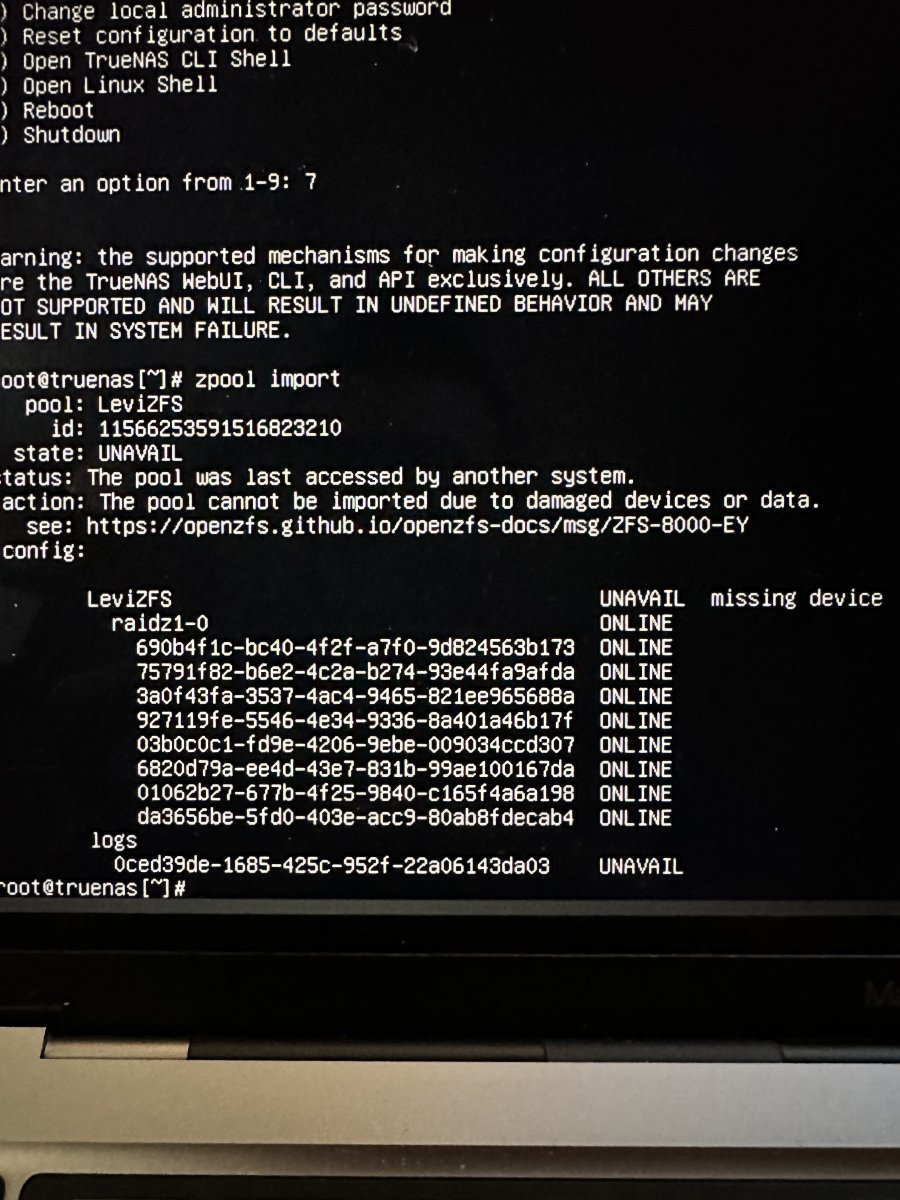

I ran 'zpool import' to see what errors would come up and the following problems were shown:
TrueNAS SCALE was unable to import the ZFS pool due to "damaged devices or data", or in this case, the missing SLOG device.

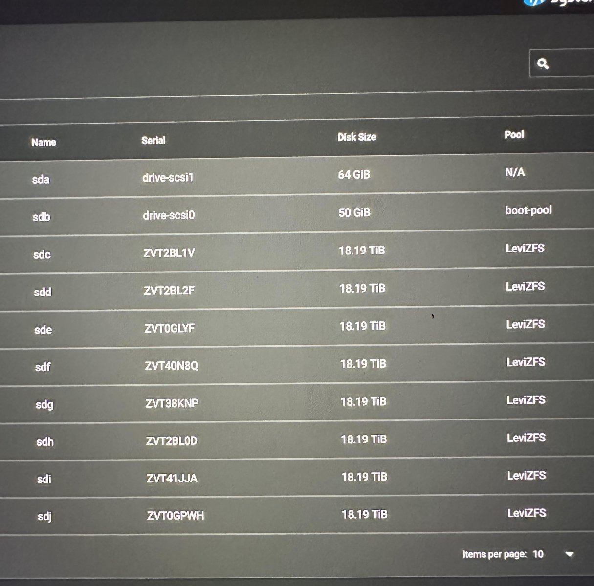

Next, I ran the 'zpool import -m -f' command to force TrueNAS to import the ZFS pool, and while successful, many errors occurred during the importing process due to the missing SLOG. After the import, I was able to see the 8x Seagate HDs in the ZFS pool under 'Disks':

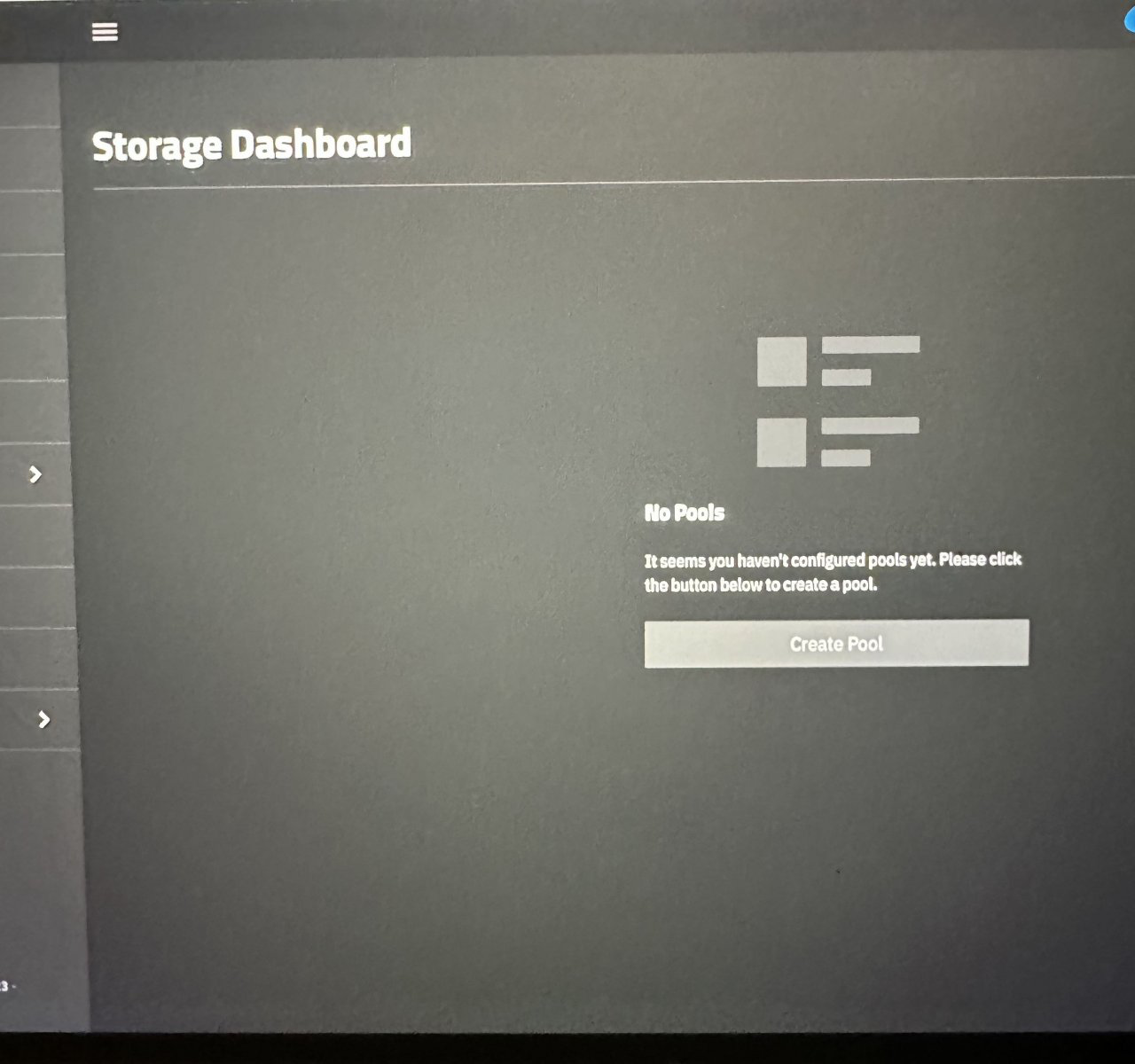

But the imported ZFS pool won't show up under the 'Storage' tab:

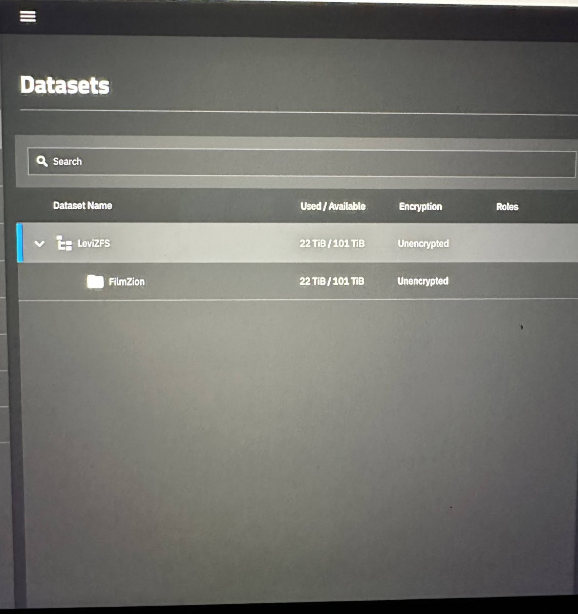

Under the 'Dataset' tab in the GUI, I was able to see the folders within the imported ZFS pool (so I think the raw data is intact):

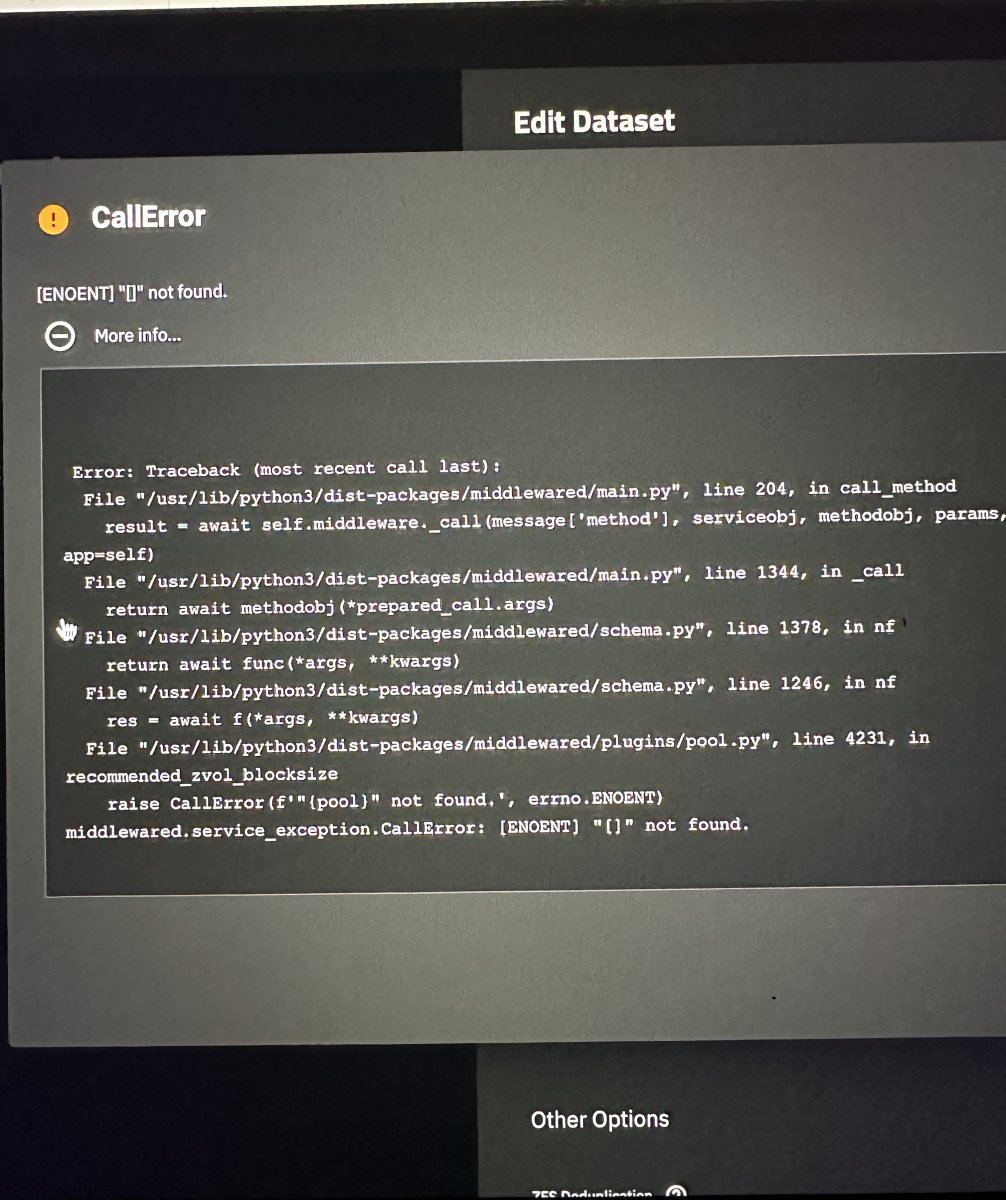

However, when I tried to check the dataset details of the 'FilmZion' folder, it gave me the following CallError message:

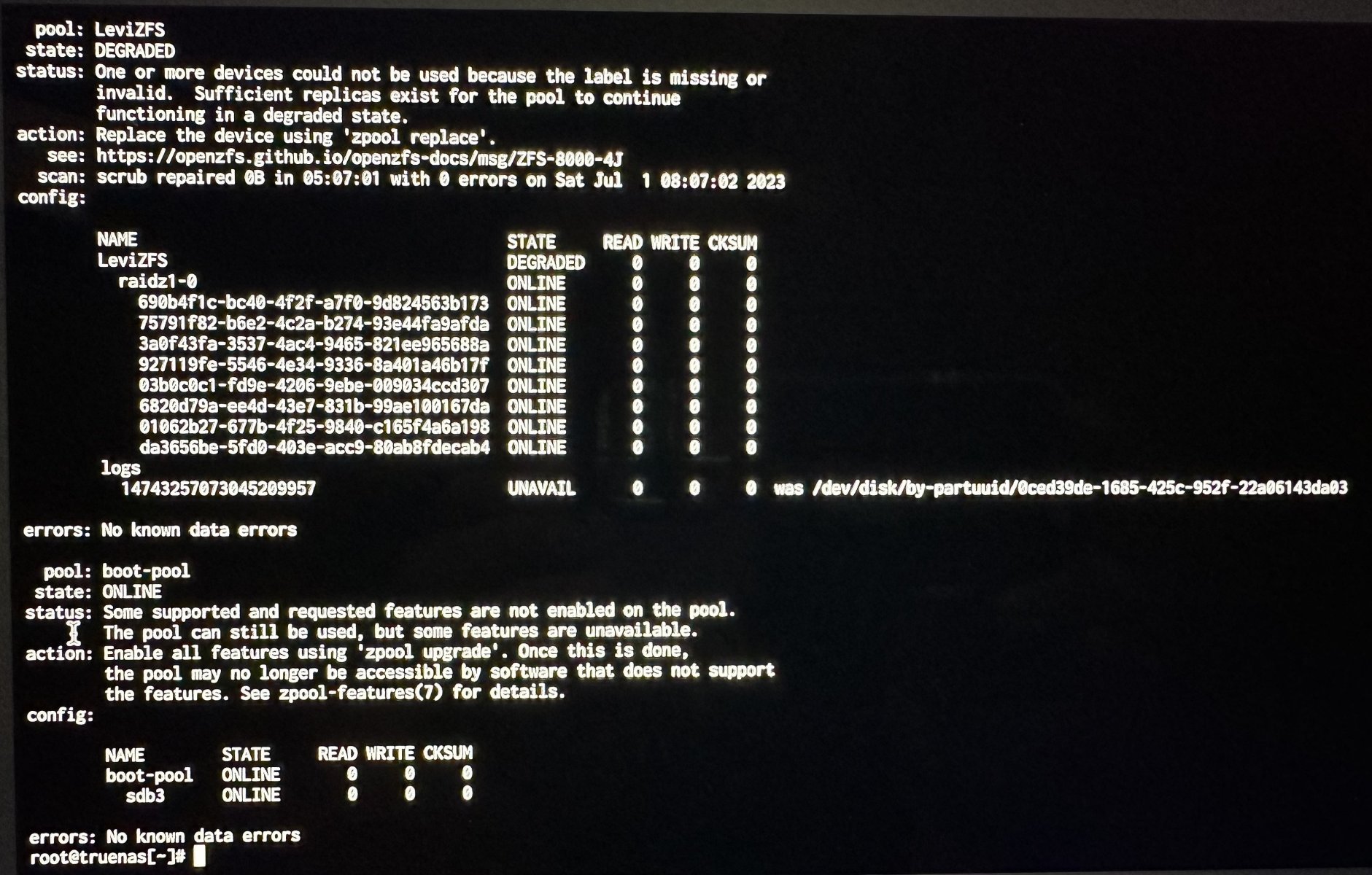

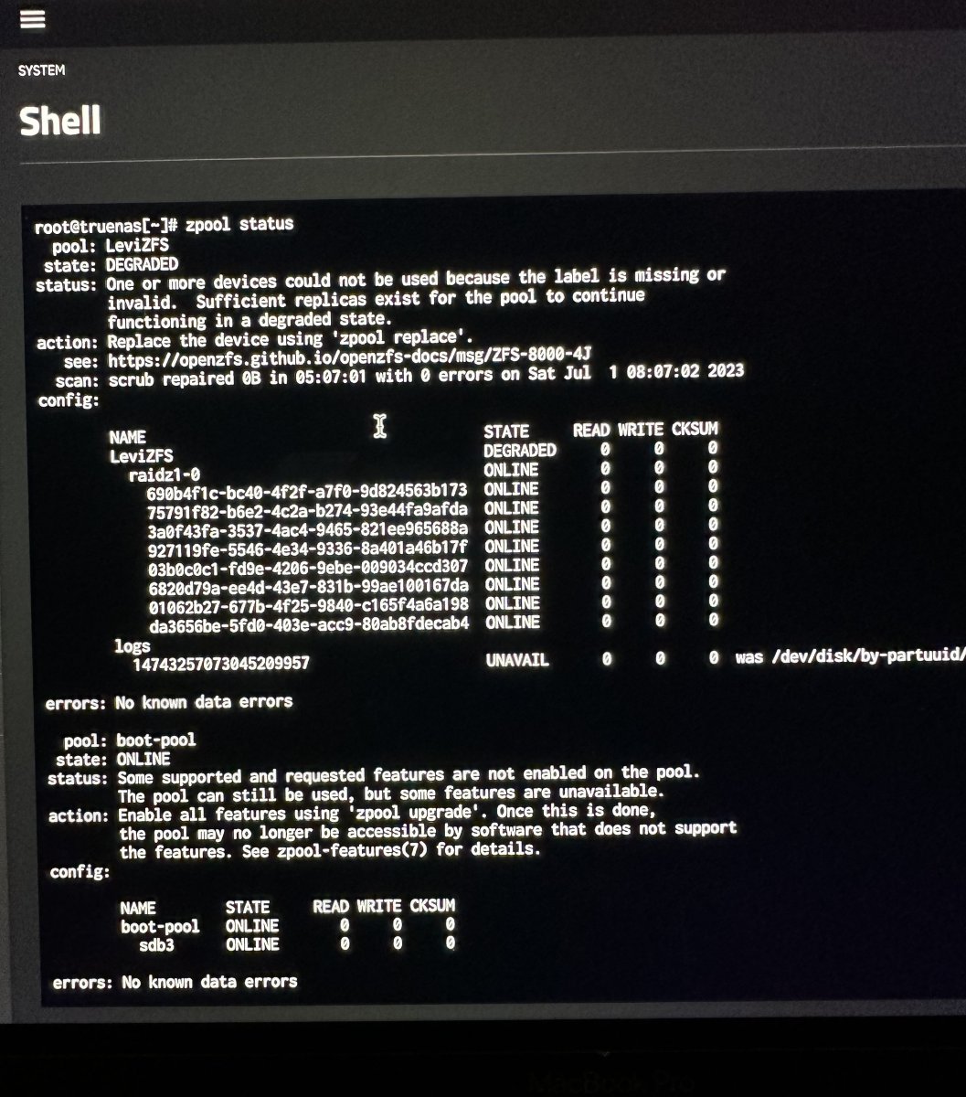

Here is the output for 'zpool status':

Good news; this is a result of the pool being imported from the command line rather than the GUI. Now that it's been imported, you should remove the SLOG device from the pool using the GUI, then export the pool and re-import it through the webUI (or reboot your server again.)
Give that a shot and let us know the results - then we can determine if the SLOG is actually necessary given your workload.
gorgashaft
Jul 14, 2023
That did the trick! I removed the SLOG device with the zpool remove command, restarted TrueNAS and I was able to add the ZFS Pool in the GUI. Thanks HoneyBadger!
