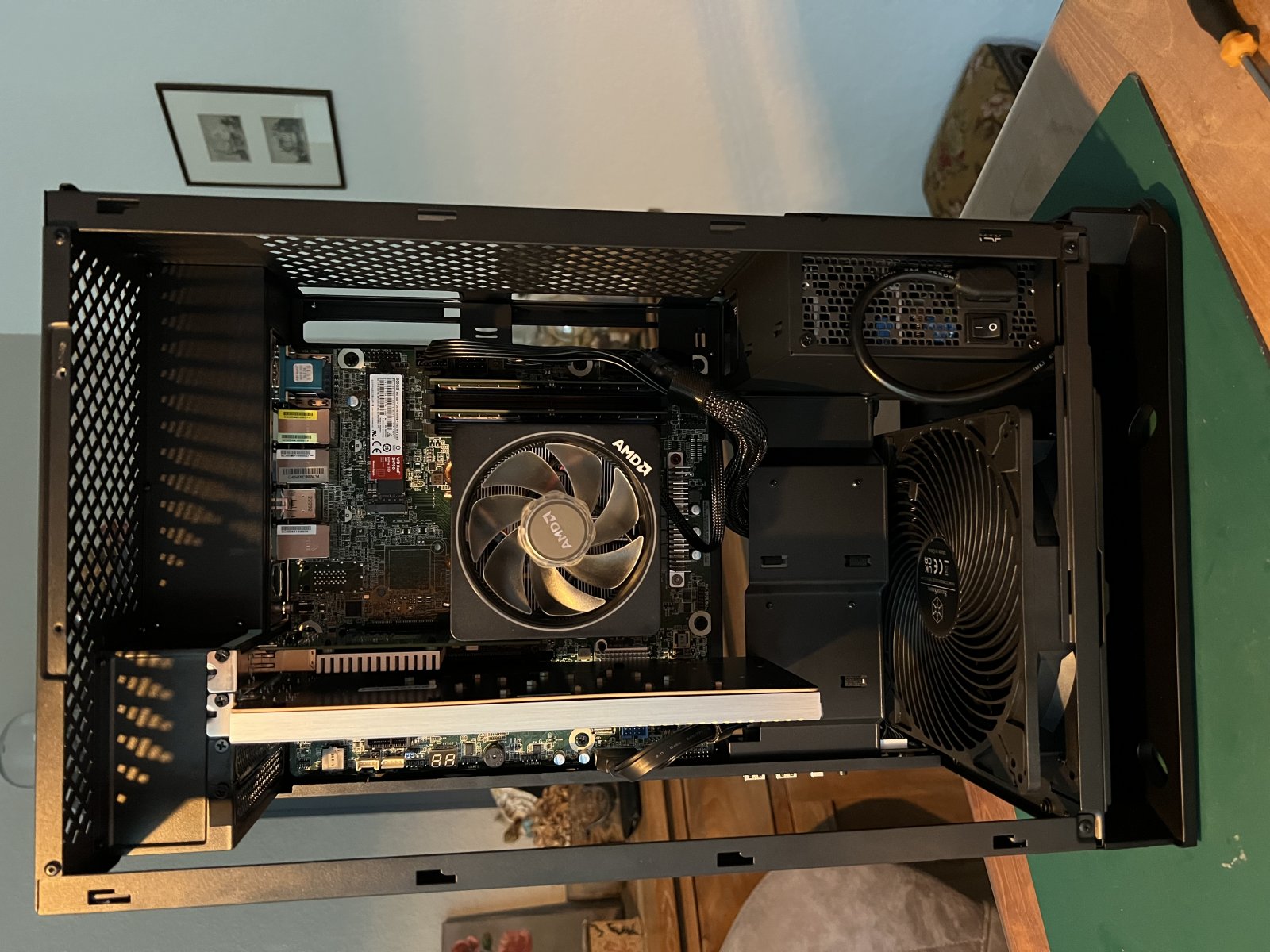

Yesterday, most components arrived (except for the two 500GB SSDs). Unfortunately, I came to the conclusion that the Noctua NH-D12L isn’t compatible with the B650D4U motherboard when the x4 PCIe slot is in use. I could use it in a sub-optimal position (air blowing to the side of the case instead of upwards), but it would not be efficient.
I have decided to use the stock AMD Wraith Prism cooler I got with the CPU (with RGB turned off, of course) and return the Noctua one.
Today will be building day! The two 500GB SSDs will arrive today, as well as a 900VA APC UPS (BR900MI). :)

The build is in progress! I might connect the UPS to my OPNsense router and use that as a NUT server. The UPS I have, is a model from 2019 with a serial/USB data port. Let’s hope it still works. :)

Ran some initial tests with the UPS under Ubuntu; it was detected immediately without any changes to the system, so I’m hopeful it’ll work out of the box. :) The system idles at 40W power consumption, full load (using the `stress` tool) it peaks at 141W. The old Synology NAS idled at 30W, so it’s not even that much more. :)
