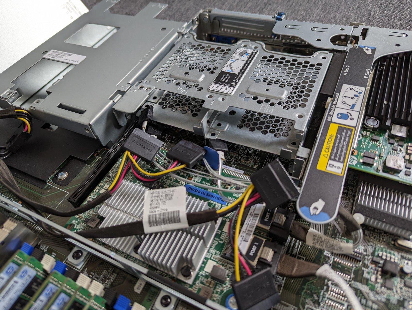

Can you describe the "SFF extender" and how it's attached?

You'll want to replace or supplement the included P440ar RAID controller with a compatible HBA. RAID controllers aren't recommended for use with TrueNAS, either SCALE or CORE.
Thank you! I'll check into that. Currently the controller is in HBA\IT-mode and each disk is seen individually including SMART data.
I can even show you. It's a case at the back internal inside the chassis. See the attached picture.
That's not sufficient.
