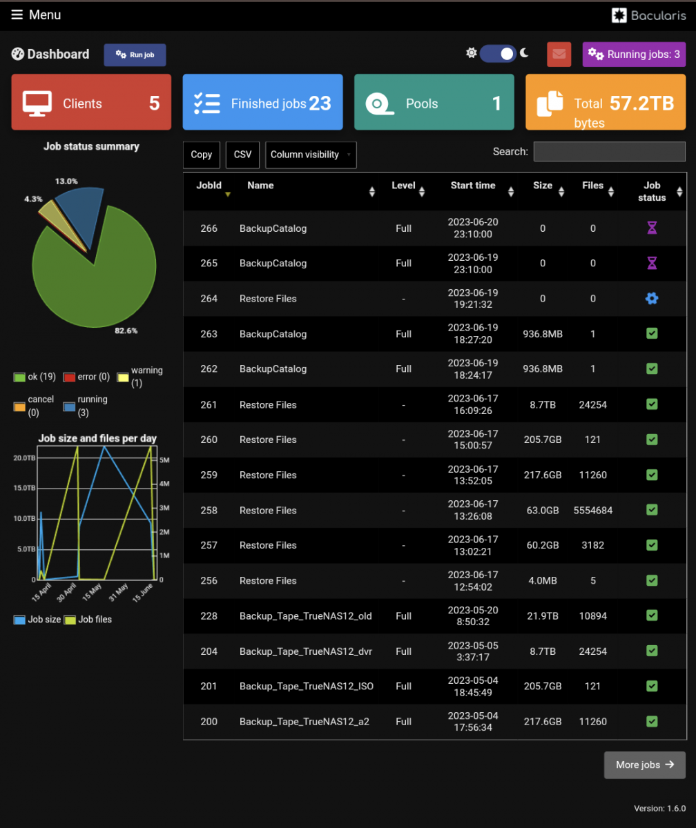

While I use bacula I find tape quite the solution. I started with an lto 5 drive. Then I went all in with an library (TL4000). I too have found documentation is lacking or just plan wrong. I just kept at it. I can fill a lto 5 tape (1.5 tb) in about 6 hours. My solution is fully virtualized. Now I'm all automated. Next is to figure out tape encryption.
