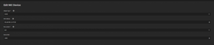

My Apps can reach bridge/host nic IP (10.0.10.160), gateway(10.0.10.10), LAN device (10.0.10.40) and internet (8.8.8.8)
However, they cannot ping VM (10.0.10.18) that is also attached to the bridge br0
VM can ping NAS host (10.0.10.160)
I cannot figure out why it would work only one way (given ping is actually 2 way)

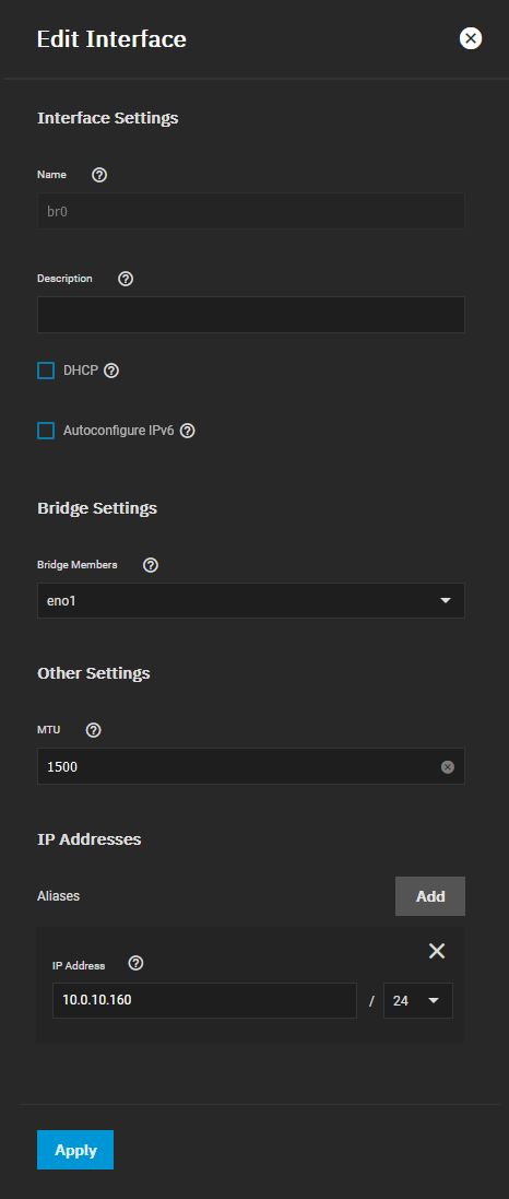

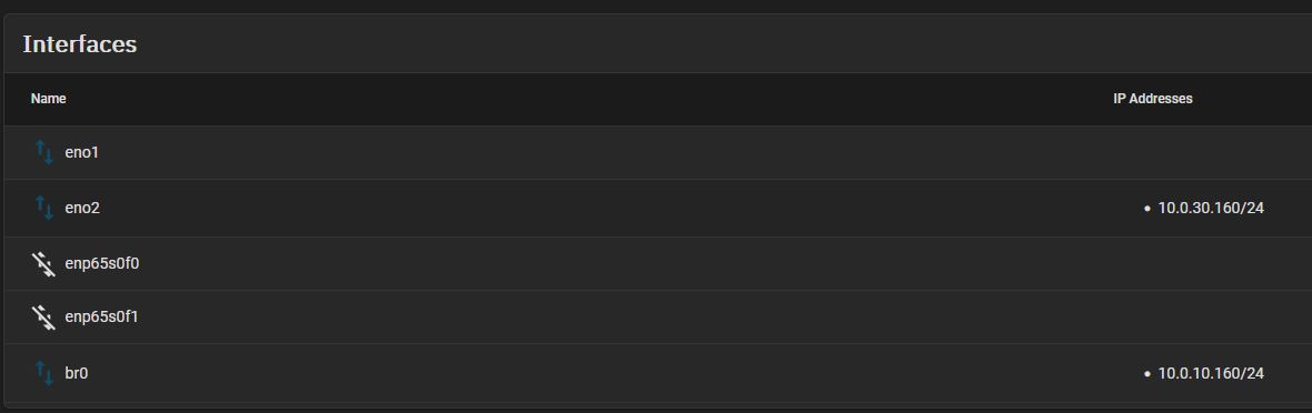

Network settings:
br0:
Kubernety settings:
  • Node IP: 10.0.10.160
  • Route v4 Interface: br0
  • Route v4 Gateway: 10.0.10.10 (my router)

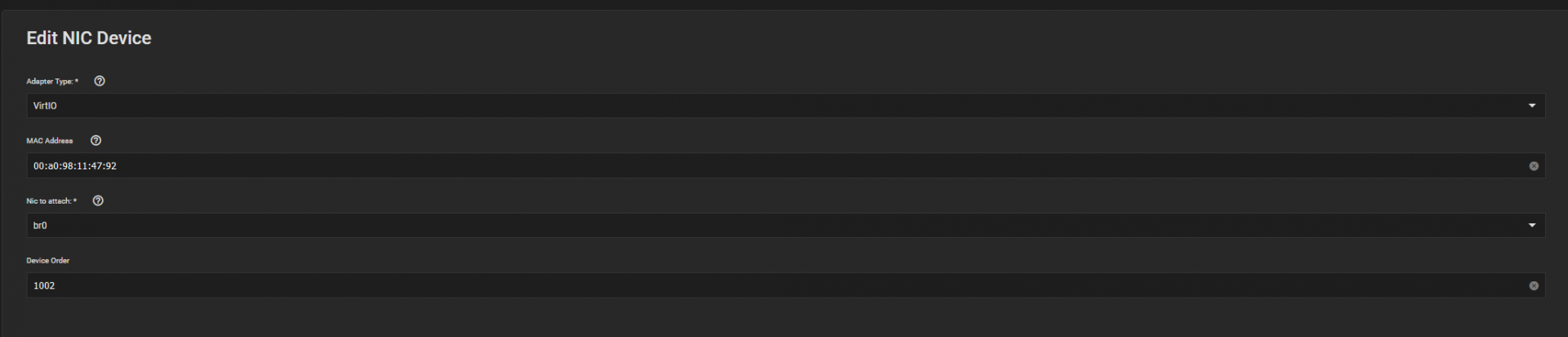

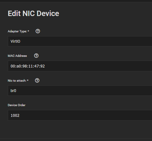

VM NIC:
