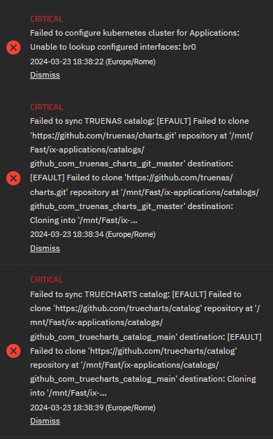

i found the (2) culprit,
1. DNS not set, i forgot to set it manualy when i set the Bridge IP
2. i get the error attached but i used this trick: Link
It's not the best situation because every time I restart I have to manually reset the apps, but for the moment it seems to work and on average I restart monthly
