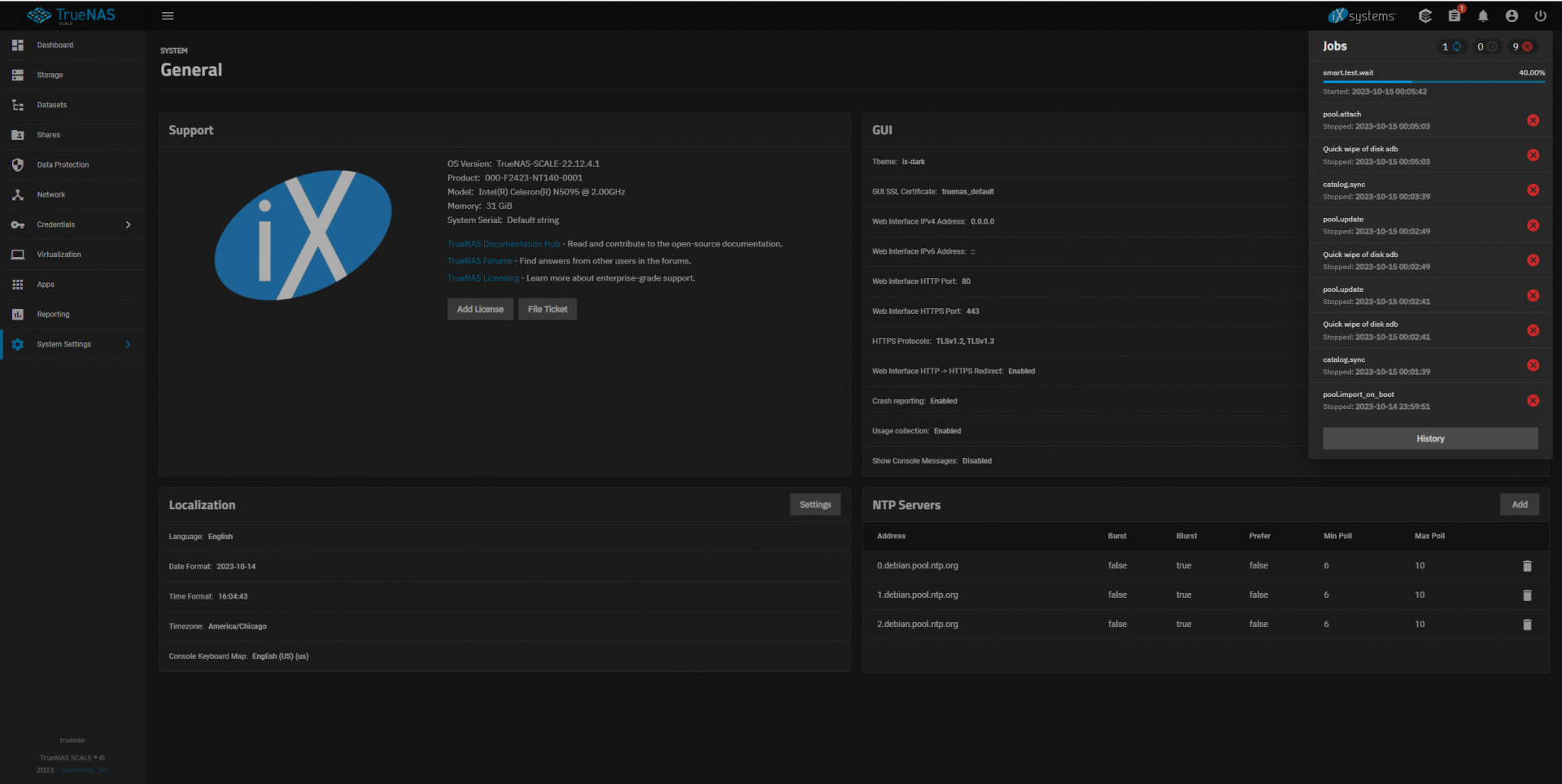

Hi All,
I find a rather weird bug. I have set my timezone to americas/chicago. I have the correct time set in general/localization but the alerts and jobs on top right is using the wrong time, and it's claiming to use americas/chicago.
Please see attached.
Gnome
Aug 18, 2011
87
Hi All,
I ran into some weirdness with time too and realised that NTP did not work correctly if the time wasn't already within a certain range.
Additionally, it seems that it sets the hardware clock to UTC.
To fix this, what I would try, if I were you, set the time in the BIOS to UTC time (down to the minute correct should be enough for NTP to correct your time).
