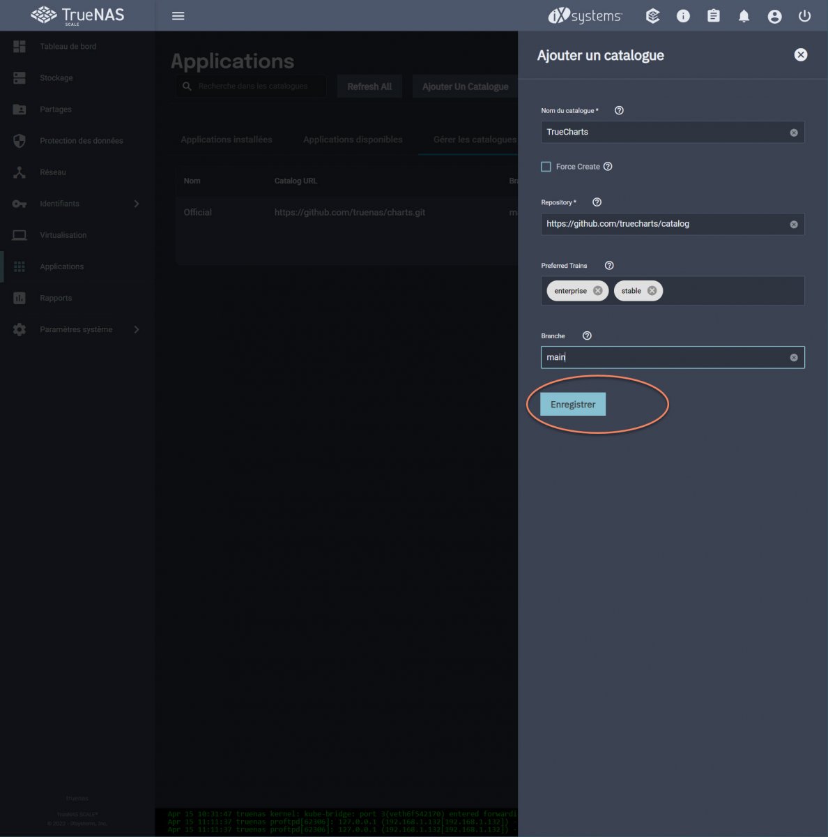

The settings:
Go to > Applications > Manage Catalogs > Add Catalog
Catalog name: TrueCharts
Repository: https://github.com/truecharts/catalog
In > Preferred Trains > Add
[stable] [core] [incubator]
Branch: hand
[Register]

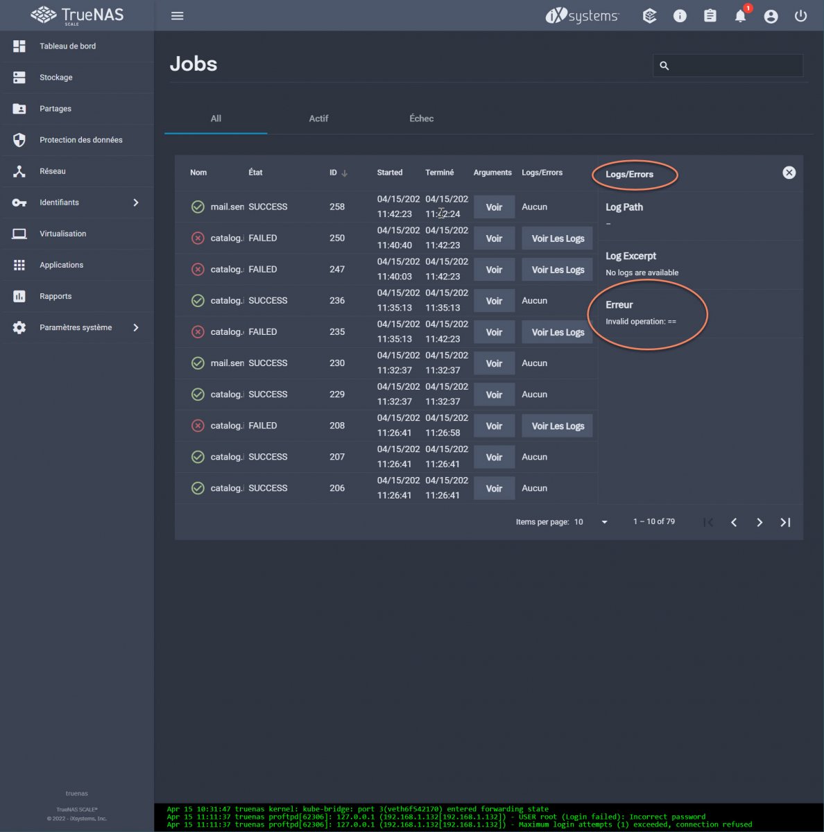

Error message in tasks:
CRITICAL
Failed to sync TRUECHARTS catalog: [EFAULT] Invalid operation: ==
2023-04-14 11:58:35 (Europe/Paris)

Branch should be "Main" not hand
Edit:
To add TrueCharts to your SCALE installation:
  1. Go to Apps page from the top level SCALE menu
  2. Select Manage Catalogs tab on the Apps page
  3. Click Add Catalog
  4. After reading the iXsystems notice, click Continue and enter the required information:
    Preferred Trains: enterprise and stable
    Branch: main
  5. Click Save and allow SCALE to refresh its catalog with TrueCharts (this may take a few minutes)

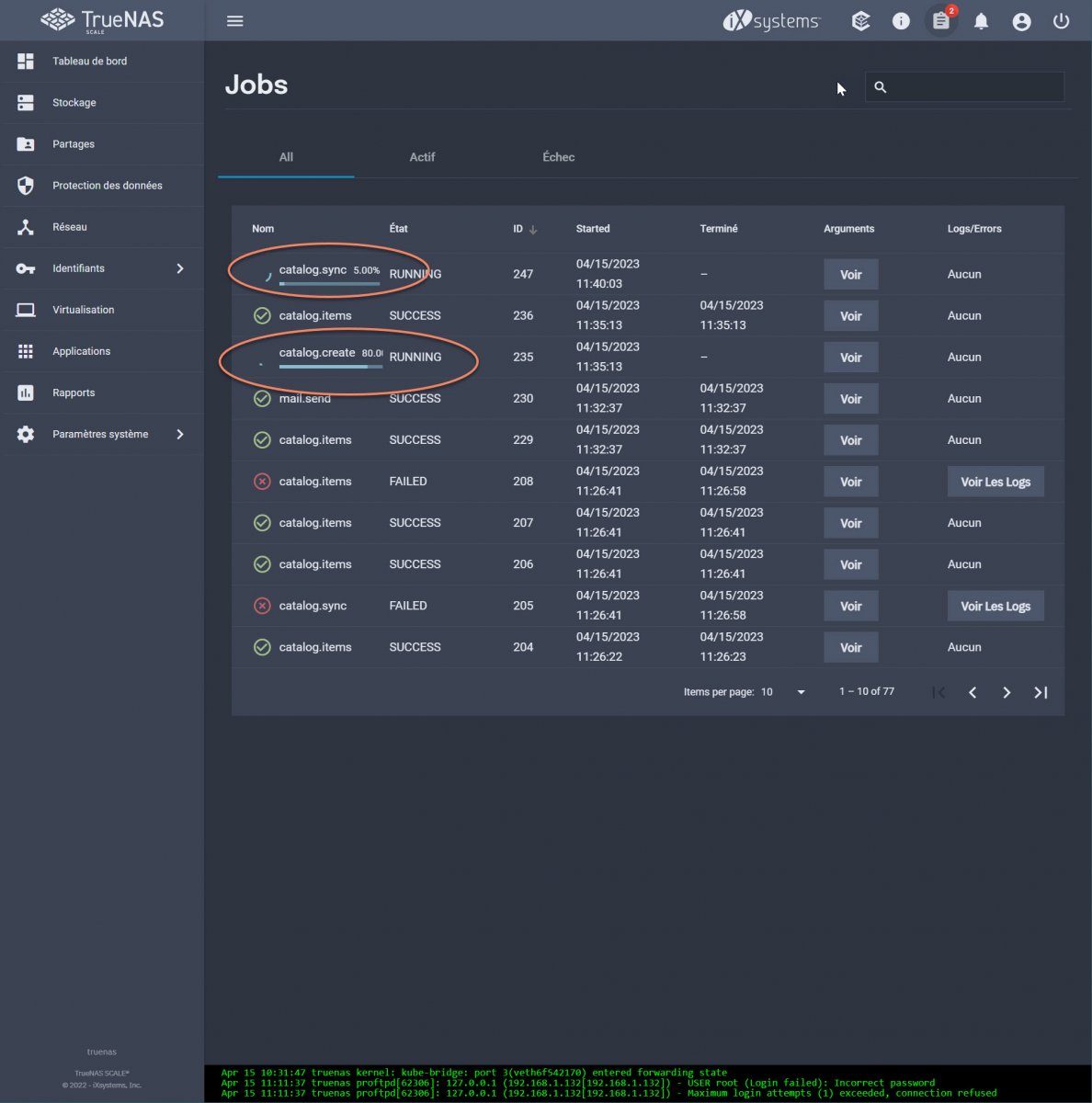

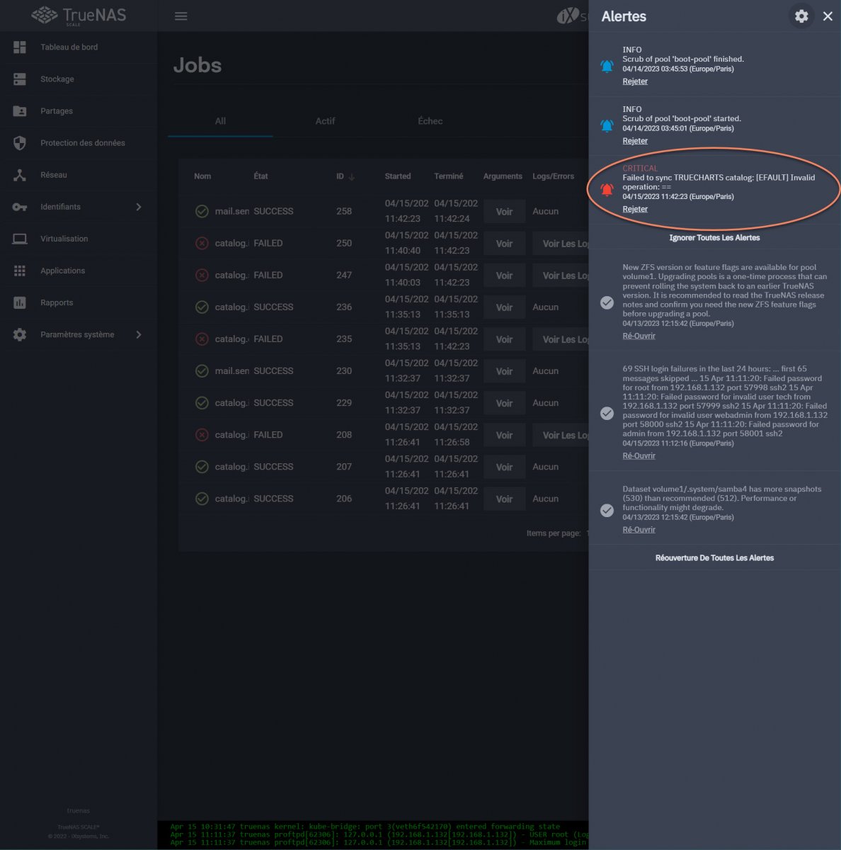

Richardszu
Jan 21, 2022
49
Thanks @LarsR and @sretalla
for your answer,
I deleted the catalog and recreated it with your advice.
It did not work ? I attach the screenshots.
I also did the same operation in a VM with Vmware Scale which was installed in DHCP mode, same failure? Is this a bug in Scale? How to get around this problem? Thanks for your help
