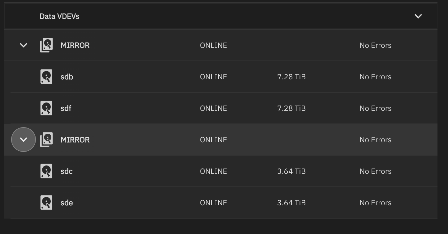

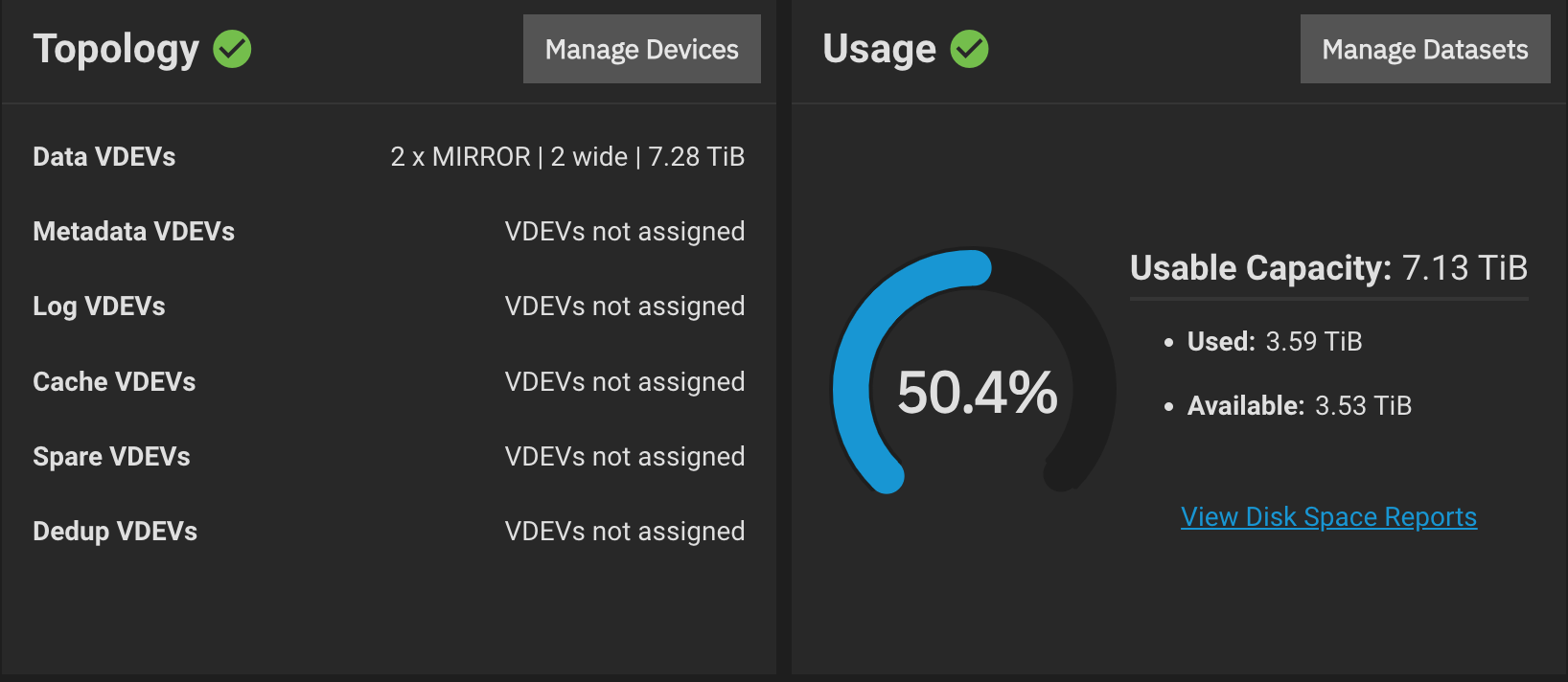

I'm almost there :)

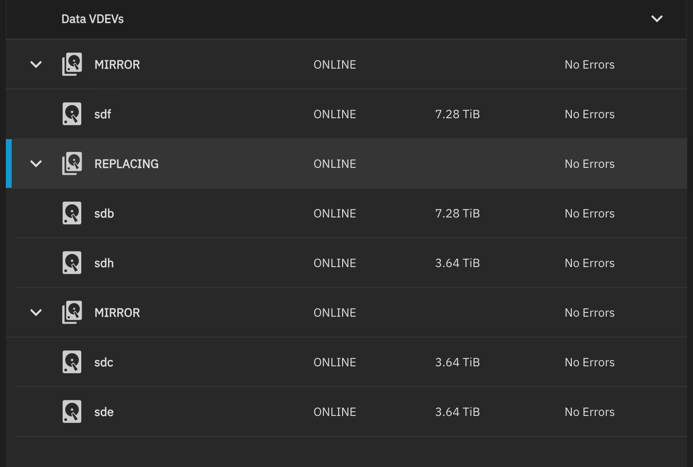

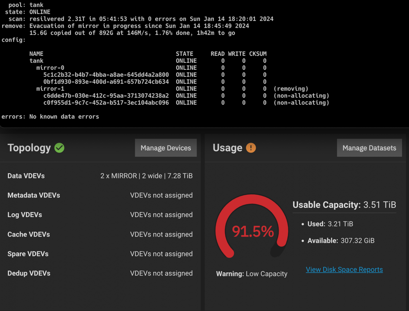

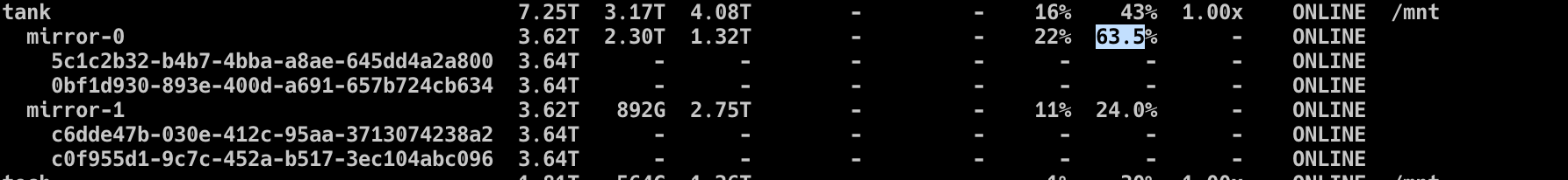

can't delete mirror-1, getting
cannot remove mirror-1: out of space
How can i overcome the issue?

NugentS
Apr 16, 2020
2,947
Do you have snapshots? If so - they may be using a lot of space. You may need to delete the snapshots first

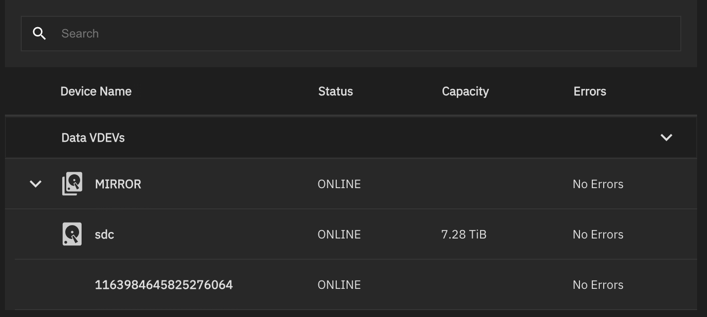

Seems like I solved the issue by freeing more space, didn't expect this would be needed after switching mirror-0 to bigger hdds.

Unfortunately, not everything went flawlessly. For unknown reasons pool degraded. One of the new disks is unavailable, the second one reports the wrong size in the pool
  pool: tank
 state: DEGRADED
status: One or more devices could not be used because the label is missing or
    invalid.  Sufficient replicas exist for the pool to continue
    functioning in a degraded state.
action: Replace the device using 'zpool replace'.
   see: https://openzfs.github.io/openzfs-docs/msg/ZFS-8000-4J
  scan: resilvered 2.31T in 05:41:53 with 0 errors on Sun Jan 14 18:20:01 2024
remove: Removal of vdev 1 copied 892G in 2h17m, completed on Sun Jan 14 21:03:33 2024
    13.5M memory used for removed device mappings
config:
    NAME                                      STATE     READ WRITE CKSUM
    tank                                      DEGRADED     0     0     0
      mirror-0                                DEGRADED     0     0     0
        11639043010271858211                  UNAVAIL      0     0     0  was /dev/disk/by-partuuid/5c1c2b32-b4b7-4bba-a8ae-645dd4a2a800
        0bf1d930-893e-400d-a691-657b724cb634  ONLINE       0     0     0
errors: No known data errors
tank                                      3.62T  2.80T   848G        -         -    27%    77%  1.00x  DEGRADED  /mnt
  mirror-0                                3.62T  2.80T   848G        -         -    27%  77.2%      -  DEGRADED
    11639043010271858211                  7.28T      -      -        -         -      -      -      -   UNAVAIL
    0bf1d930-893e-400d-a691-657b724cb634  3.64T      -      -        -         -      -      -      -    ONLINE
  indirect-1
truenas# lsblk
NAME                                                                                                    MAJ:MIN RM   SIZE RO TYPE  MOUNTPOINTS                                                                                                   8:2    0 221.6G  0 part
sdb                                                                                                       8:16   0   7.3T  0 disk
└─sdb1                                                                                                    8:17   0   3.6T  0 part                                                                                                  8:66   0   3.6T  0 part
sdf                                                                                                       8:80   0   7.3T  0 disk
└─sdf1                                                                                                    8:81   0   7.3T  0 part
truenas# zpool get autoexpand tank
NAME  PROPERTY    VALUE   SOURCE
tank  autoexpand  on      local

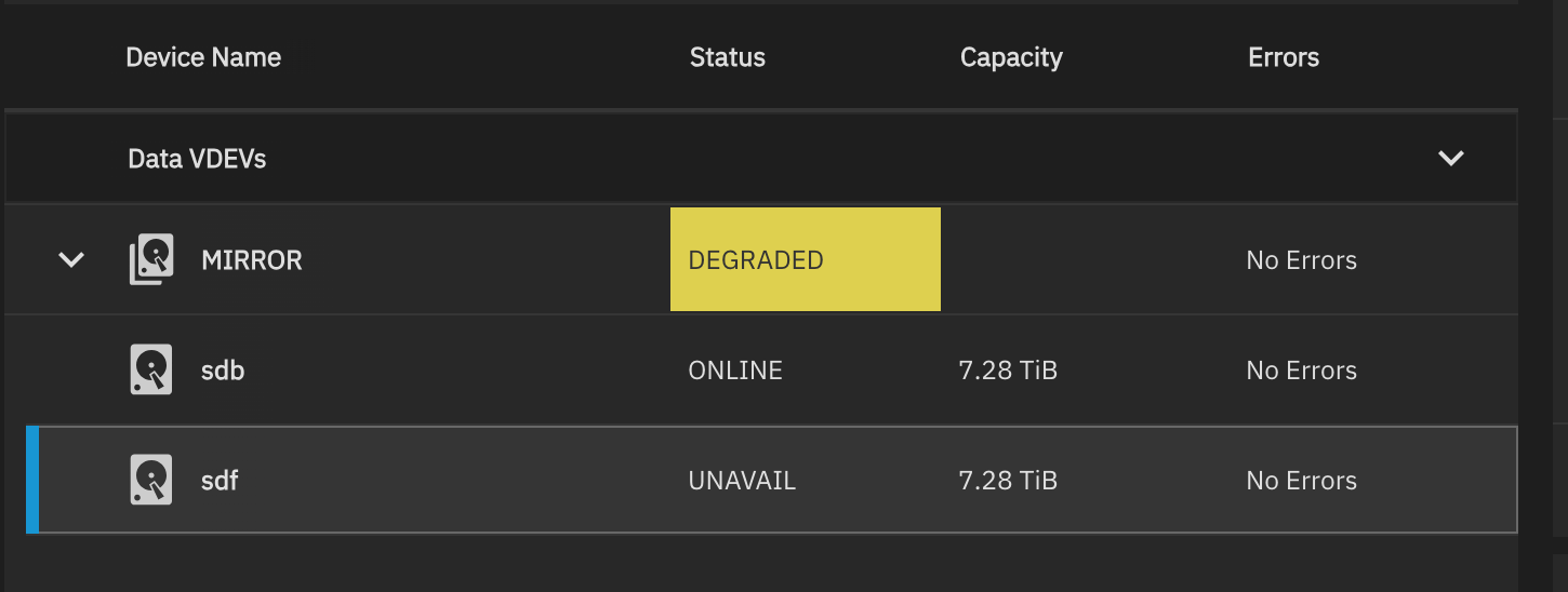

Weird things happened, so after the disk replacement with the same disk and resilvering, the pool became healthy, the space didn't expand automatically even after reboot so I tried to do it manually via console using
zpool online -e tank gptid/ for both disks
- nothings changed.
So I hit the EXPAND button in UI and got some feedback:
Command partprobe /dev/sdf failed (code 1): Error: Partition(s) 1 on /dev/sdf have been written, but we have been unable to inform the kernel of the change, probably because it/they are in use. As a result, the old partition(s) will remain in use. You should reboot now before making further changes.
after a while disk was just kicked off the pool...
P.S. i think that is enough of games, as it seems there is a bug in SCALE-23.10.1, will backup data and recreate the pool
