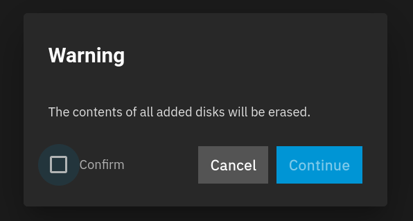

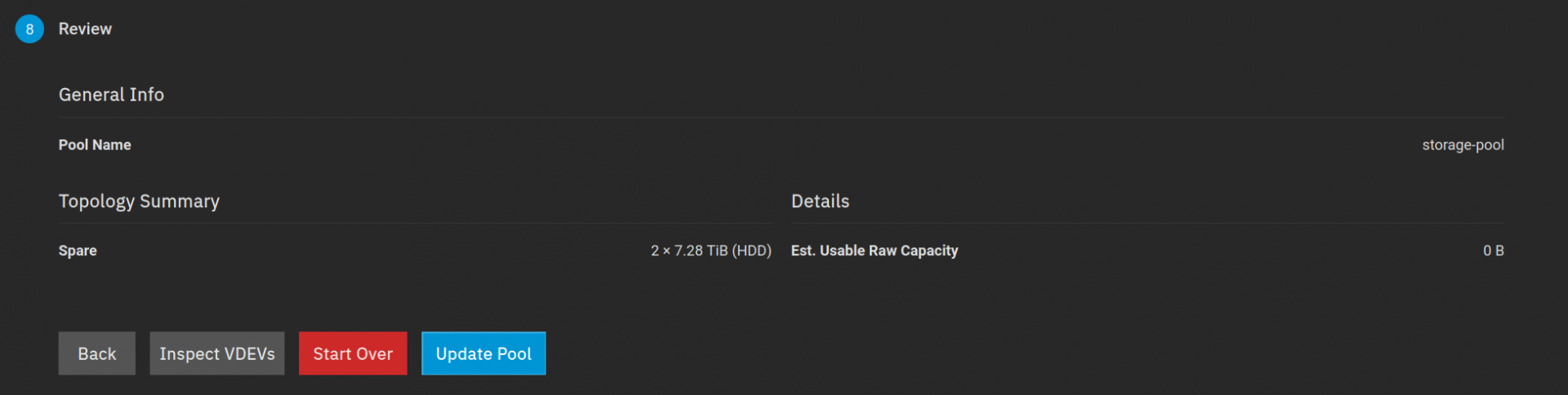

I'm currently using TrueNAS Scale 23.10.0.1 with 3x8TB in RAIDz1. I now want to add 2x8TB as spare disks if some of the existing disks fail.
When clicking on "Update Pool" to confirm the changes, I receive the following warning:
I assume that only the new added drives will be formatted, is this correct? I really don't want my whole pool to be formatted since I have important data there.

Correct. Take the scare as reminder that "ZFS is not a backup": If you have "important data" in there, you should have a backup.
