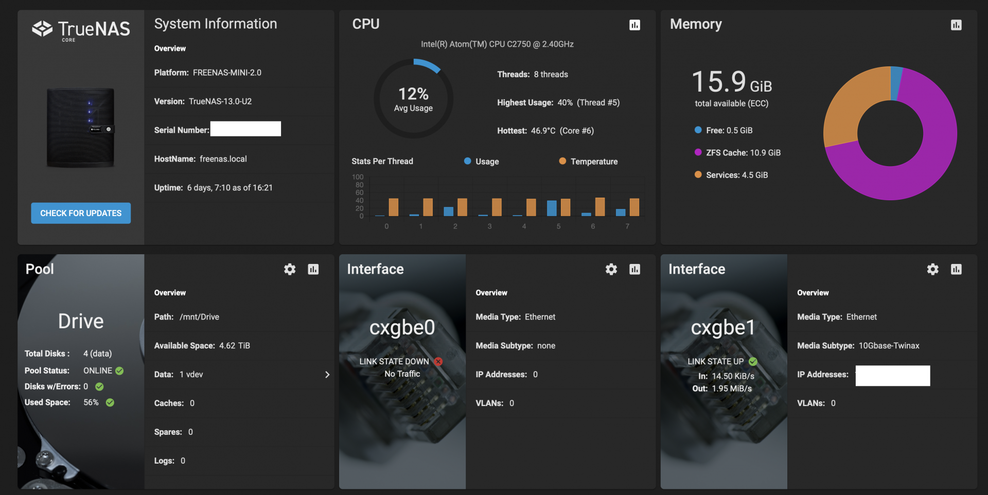

David Simpson
Nov 24, 2015
26
@ChrisRJ @HoneyBadger Does this give enough information? The drives are from 2015, and I can upgrade to 32gb of memory but I'm not sure if I should keep investing in this or if I should upgrade to something new. Transfers start fast and slow down, I'm guessing because these old drives have such a small cache it quickly runs out of steam
I primarily use it for SMB storage for Macs, Time Machine, and running a Plex Server. All of which it handles great, I just wish it had a little more in the tank for transfers now that I have dual 10Gb nics
Inbound transfers (writes) will start at nearly wire speed (10Gbps) but will rapidly throttle down to the actual speed of the backing vdevs (your four drives) - this won't be improved by a write log device unfortunately.
Reads might see improvement from an L2ARC device as discussed previously.
You're at 56% space used, so you shouldn't quite be seeing slowdown from that. One core question is what exact model of drives you have; you did mention WD Red, and 2015 should be prior to the SMR shenanigans, but that should be confirmed.

To saturate 10 Gbps with a small number of drives, you will need SSDs. For any more specific answer, we need numbers and you did the testing that lead to those. In other words: Fast means different things to different people (just like real-time, but that is a different topic).

here is the exact model:
Western Digital 4TB WD Red Plus NAS Internal Hard Drive HDD - 5400 RPM, SATA 6 Gb/s, CMR, 64 MB Cache, 3.5" - WD40EFRX
