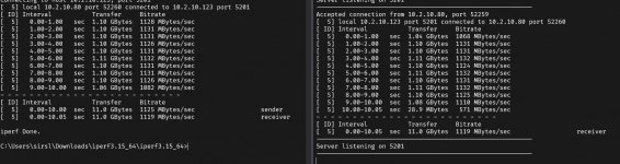

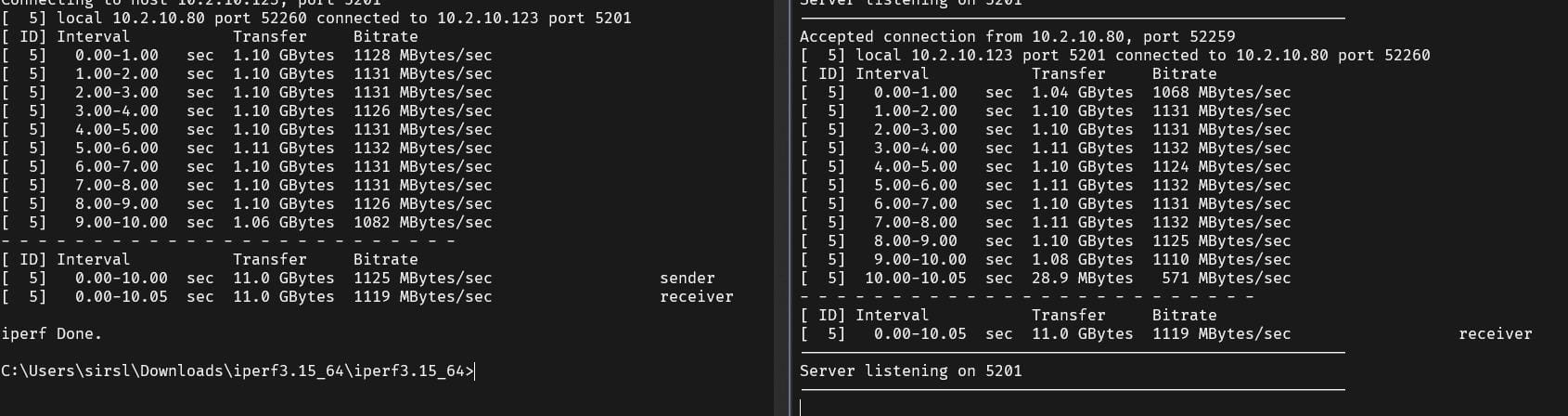

chuck32
Jan 14, 2023
623
No problem! I can't imagine I'm the first scale use to use an x520 though.
Keep in mind my I only used one port because I don't have a switch to test something like link aggregation and obviously I dont have enough working transceivers ;)
But again, I don't see why you couldn't use both ports / why they shouldn't work.
