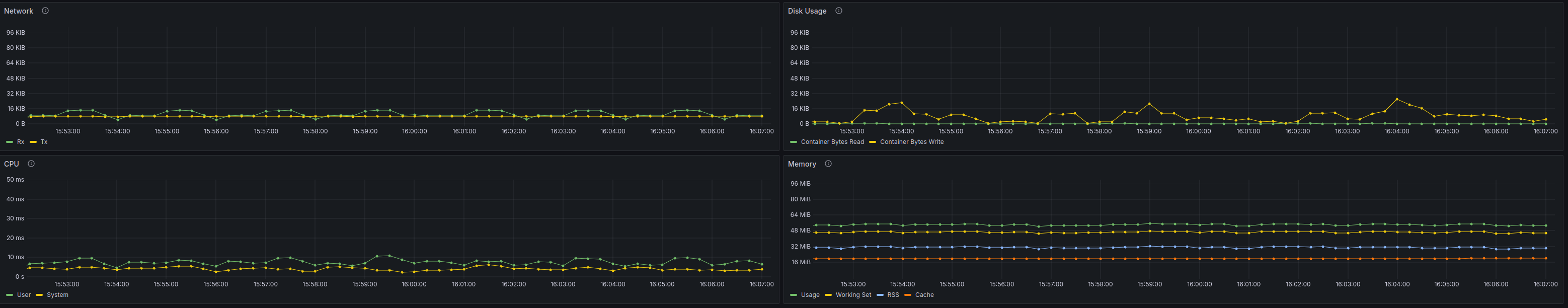

Run docker compose up to deploy the three containers. cAdvisor reads from the cgroup and reports container-level metrics to Prometheus. Grafana can then be used to display these metrics, as seen in the following dashboard:
Grafana dashboard with TrueCommand running and connected to three TrueNAS systems
Figure 1: Grafana dashboard with TrueCommand running and connected to three TrueNAS systems
