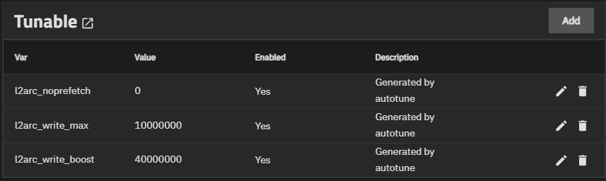

Tunable Card
The Tunable card shows the existing sysctl settings on the system.
Tunable Card
Figure 19: Tunable Card
Clicking on the card header opens the Tunables screen with a list view of any configured scripts, the Columns dropdown with options to change the columns shown in the table, and the Add button.
Add to add a tunable that configures a kernel module parameter at runtime.

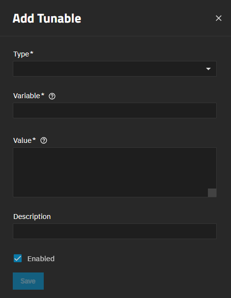

Add Tunable Screen
The Add Tunable configuration screen allows setting up tunables to configure Linux kernel parameters at runtime, UDEV rules for detected hardware, or ZFS module parameters for the ZFS kernel module on Linux.
Add Tunable Screen
Figure 20: Add Tunable Screen
Tunable Settings
SettingsDescription
TypeSets the type of tunable to configure. Options:
  • SYSCTL - Use to set Linux kernel parameters (called sysctl variables) that tune low-level kernel behavior across networking, memory management, virtual memory, file descriptors, security hardening and more that affect the entire system. Best used for general system performance, network stack, memory pressure, security hardening (e.g., against SYN floods: net.ipv4.tcp_syncookies=1). They are written to /proc/sys/ at runtime via sysctl -w and are made persistent via files in /etc/sysctl.d/ or /etc/sysctl.confM/. Variables persist across system reboots if set in config files.
  • UDEV - Use to set UDEV rules, which are dynamic device manager configurations that run with when the kernel detects hardware events (e.g, disk plugged in, USB device attached, block device created). Variables are applied per device or per subsystem. They are ideal for hardware-specific tuning, especially disks/SSDs in ZFS pools (e.g., forcing consistent I/O scheduler, readahead, or queue depth) on pool drives to avoid defaults that hurt ZFS performance. They are applied when the rules files ending in .rules in /etc/udev/rules.d. The udev daemon (udevd) parses them on device events. They are permanent when the rule file exists, and rules re-apply automatically on device add/remove operations.
  • ZFS - Use to set OpenZFS module parameters for the ZFS kernel module on Linux. They control ZFS-specific behavior like ARC caching, compression, I/O scheduling, prefetching, recordsize limits and more. Use for fine-tuning ZFS performance, memory usage (ARC/L2ARC), compression, dedup, scrub/resilver behavior, and I/O patterns. They only apply to ZFS filesystem/modules, and are applied when written to /sys/module/zfs/parameters/ at runtime (after module load). Runtime changes are lost on reboot or module reloads. Use modprobe config for boot-time persistence.
VariableSets the name of the sysctl variable to configure. Sysctl tunables configure kernel parameters while the system runs and generally take effect immediately.
ValueEnter a value for the tunable. For a SYSCTL tunable, enter a sysctl value to use for the loader, sysctl variable.
DescriptionEnter a description for the tunable.
EnabledSelect to enable this tunable. Leave clear to disable this tunable without deleting it.

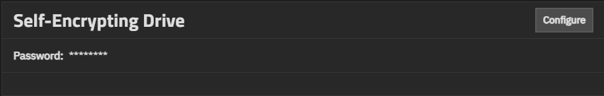

UI management of Self-Encrypting Drives (SED) is an Enterprise-licensed feature in TrueNAS 25.04 (and later) that requires an active SED license. SED configuration options are not visible in the TrueNAS Community Edition. Community users wishing to implement SEDs can continue to do so using the command line sedutil-cli utility.
The Self-Encrypting Drive (SED) card shows when the system has self-encrypting drives and is licensed for SED.
Self-Encrypting Drive Card
Figure 31: Self-Encrypting Drive Card
Configure opens the Self-Encrypting Drive configuration screen.
Self-Encrypting Drive Configuration Screen
The Self-Encrypting Drive configuration screen allows users to set the ATA security user and create a SED global password.
Self-Encrypting Drive Config Screen
Figure 32: Self-Encrypting Drive Config Screen
Self-Encrypting Drive Settings
SettingsDescription
SED PasswordSets the global password to unlock self-encrypting drives (SEDs). Enterprise-licensed feature available for systems with SED drives.
Confirm SED PasswordConfirms the global password that must exactly match the SED password.
For more information on SEDs, see Managing Self-Encrypting Drives (SED), Importing Pools, and the Import Pool content in the Storage Dashboard Screens articles.

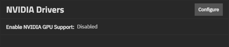

The NVDIA Drivers card shows the status of NVIDIA GPU support in TrueNAS. When TrueNAS is not equipped with an NVIDIA GPU device, the status shows as disabled.
NVIDIA GPU support is required before containers or VMs can use NVIDIA GPUs for graphics acceleration or computation.
NVIDIA Drivers Card
Figure 35: NVIDIA Drivers Card
Configure opens the NVIDIA Drivers configuration screen.
NVIDIA Drivers Configuration Screen
Figure 36: NVIDIA Drivers Configuration Screen
Enable NVIDIA GPU Support enables NVIDIA support for containers and VMS.
Save retains the changes and closes the screen.
