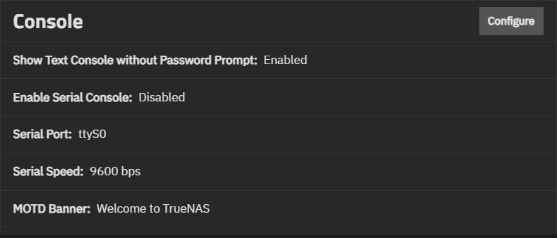

Console Widget
The Console widget on the System Setting > Advanced screen displays current console settings for TrueNAS.
Console Widget
Figure 2: Console Widget
Configure opens the Console configuration screen.
Console Configuration Screen
Console settings configure how the Console setup menu displays, the serial port it uses and the port speed, and the banner users see when accessing it.
Click Here for More Information
SettingsDescription
Show Text Console without Password PromptSelect to display the console without being prompted to enter a password. Leave empty to add a login prompt to the system before showing the console menu.
Enable Serial ConsoleSelect to enable the serial console. Do not select this if the serial port is disabled.
Serial PortEnter the serial console port address.
Serial SpeedSelect the speed (in bits per second) the serial port uses from the dropdown list. Options are 9600, 19200, 38400, 57600, or 115200.
MOTD BannerEnter the message you want to display when a user logs in with SSH.

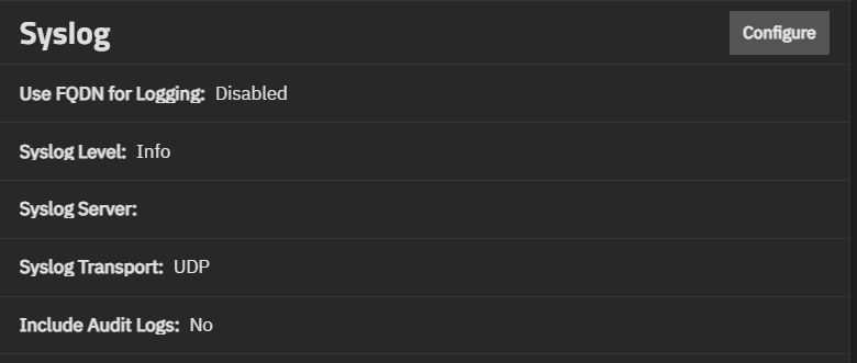

Syslog Widget
The Syslog widget displays the existing system logging settings that specify how and when the system sends log messages to the syslog server.
Syslog Widget
Figure 4: Syslog Widget
Configure opens the Syslog configuration screen.
Syslog Configuration Screen
The Syslog settings specify the logging level the system uses to record system events to the boot device. There are also options to configure a remote syslog server for recording system events.
SettingsDescription
Use FQDN for LoggingSelect to include the fully-qualified domain name (FQDN) in logs to identify systems with similar host names.
Syslog LevelSelect the minimum log priority level to send to the remote syslog server. The system only sends logs at or above this level.
Syslog ServerEnter the remote syslog server DNS hostname or IP address. Add a colon and the port number to the hostname to use non-standard port numbers, like mysyslogserver:1928. Log entries are written to local logs and sent to the remote syslog server.
Syslog TransportEnter the transport protocol for the remote system log server connection. Selecting Transport Layer Security (TLS) displays the Syslog TLS Certificate and Syslog TSL Certificate Authority fields. This setting requires preconfiguring both the server system certificate and the certificate authority (CA).
Syslog TLS CertificateDisplays after selecting TLS in Syslog Transport. Select the transport protocol for the remote system log server TLS certificate from the dropdown list. Select the default or add the certificate and CA for the server using the Credentials > Certificates screen Certificates widget.
Syslog TLS Certificate AuthorityDisplays after selecting TLS in Syslog Transport. Select the TLS CA for the TLS server from the dropdown list. If not using the default, create the CA for the systlog server TLS certificate on the Credentials > Certificates > Certificate Authorities screen.

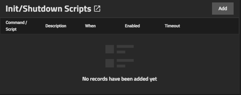

Init/Shutdown Scripts Widget
The Init/Shutdown Scripts widget displays No Init/Shutdown Scripts configured until you add either a command or script, then the widget lists the scrips configured on the system.
Figure 9: Init/Shutdown Scripts Widget
Add opens the Add Init/Shutdown Script configuration screen. Any script listed is a link that opens the Edit Init/Shutdown Script configuration screen populated with the settings for that script.
