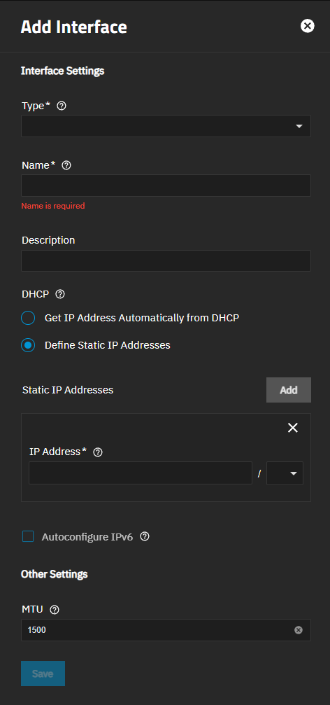

To add another network interface, go to Network and click Add on the Interfaces widget to open the Add Interface screen. Leave the DHCP checkbox clear. Scroll down to the bottom of the screen and click Add to the right of Aliases, and enter the static IP address for the interface.
You must specify the type of interface to create. Select the interface type from the Type dropdown options: Bridge, Link Aggregation (LAGG), or VLAN (virtual LAN). The interface type cannot be changed after clicking Save. To change the interface type, delete the interface and then add a new interface with the correct type selected.
Each interface type displays new fields on the Add Interface screen.

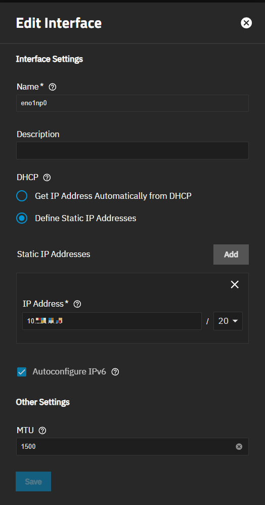

To change an existing interface, select the existing interface listed on the Interfaces widget and click Edit to open the Edit Interface screen.
The Edit Interface and Add Interface settings are identical but the Type and Name fields are not editable after saving an interface. Name shows on the Edit Interface screen, but you cannot change the name. Type only shows on the Add Interface screen. If you make a mistake with either and clicked Save, the only option to change either setting is to delete the interface and create a new one with the desired name and type.
To change from a DHCP-provided IP address to a static IP, you must also add the new default gateway and DNS name servers that work with the new IP address.
Click Save after making all changes.

To change an interface from using DHCP to a static IP address:
Click on the Edit icon for the interface on the Interfaces widget to open the Edit Interface screen, then clear the DHCP checkbox.
Click Add to the right of Aliases to show the IP address fields, then enter the new static IP and select the CIDR number from the dropdown list.
Multiple interfaces cannot be members of the same subnet!
If an error displays or the Save button remains inactive when setting the IP addresses on multiple interfaces, check the subnet and ensure the CIDR numbers are different.
Click Save.
