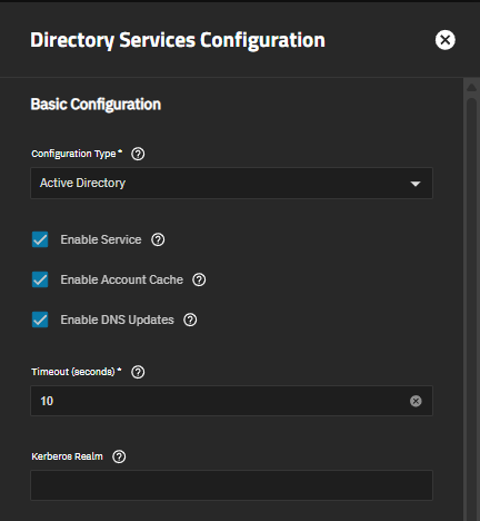

To connect to Active Directory, in SCALE:

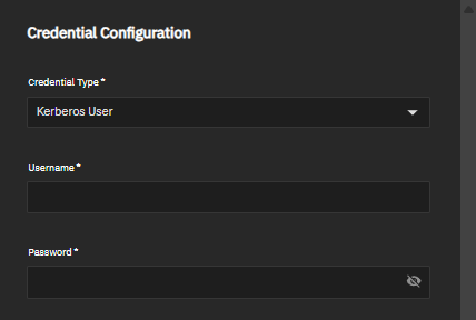

  1. Go to Credentials > Directory Services click Configure Active Directory to open the Active Directory configuration screen.
  2. Enter the domain name for the AD in Domain Name and the account credentials in Domain Account Name and Domain Account Password.
  3. Select Enable to attempt to join the AD domain immediately after saving the configuration. SCALE populates the Kerberos Realm and Kerberos Principal fields on the Advanced Options settings screen.
ActiveDirectoryBasicOptions
  1. Click Save.
TrueNAS offers advanced options for fine-tuning the AD configuration, but the preconfigured defaults are generally suitable.
