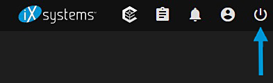

Some TrueNAS models do not support using the UI Shutdown option on the power menu. Instead of shutting down the server, it only reboots.
To shut down a TrueNAS Enterprise HA system, log into the IPMI connections for each controller and use the Console Setup menu option to shut down the system.
Selecting the TrueNAS UI Shutdown option in the power menu to shut down the HA system only causes the system to fail over to the standby controller.
