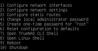

To use the Console setup menu to configure required network settings on controller 1:
TrueNAS Console Setup Menu
Figure 7: TrueNAS Console Setup Menu

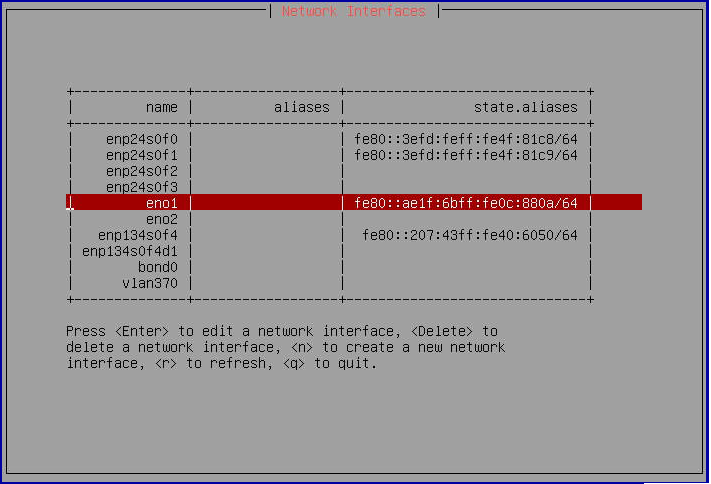

  1. Type 1 and then press Enter to open the Network Interfaces screen.
  2. Use either Tab or the arrow keys to select the interface assigned as your primary network interface. If you have more than one interface installed and wired to your network, the primary interface is typically eno1. With the interface highlighted, press Enter to open the Update Network Interface screen.

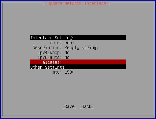

  3. Tab or arrow down to ipv4_dhcp and change it to no.
  4. Tab or arrow down to the aliases setting and enter the static IP address for controller 1. Tab or arrow down to Save, and then press Enter. A pending network changes notice displays with additional options.
  5. Type a to apply the change, then p to make it persist. Type q to return to the main Console setup menu.

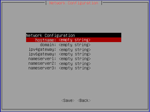

  6. Type 2 and then press Enter to open the Network Configuration screen.
  7. Use either Tab or the arrow keys to select each field. Type the value for each field listed below. Press Enter after each value.
    FieldDescription/Example
    hostnameThe host name you assign to controller 1. For example m50-123-1.
    domainThe domain name for the nework controller 1. For example my.companyname.net
    ipv4gatewayThe default gateway IP address for your network.
    nameserver1
    nameserver2
    The IP addresses for your network DNS servers.
  8. Use either Tab or the arrow keys to select Save, then type q to return to the main Console setup menu.

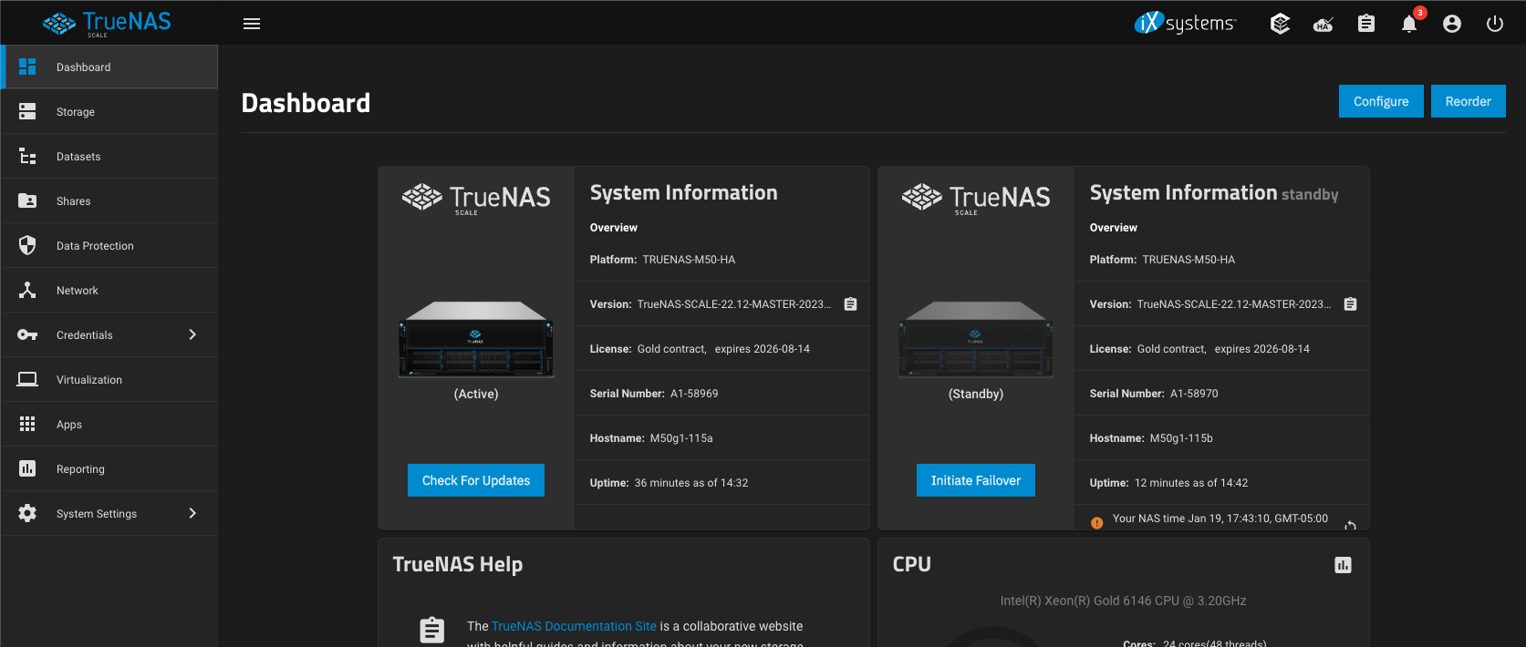

Go to System > General Settings and click Add License on the Support widget. Copy your license and paste it into the License field, then click Save License. The Reload dialog opens. Click Reload Now. Controller 1 restarts, and displays the EULA for controller 2. Sign the EULA agreement for controller 2, and add the license.
The controller 1 and 2 (or a and b) serial numbers display on the Support widget on the System > General Settings screen.

When the system comes back up, log into TrueNAS using the virtual IP address. The main Dashboard displays two System Information widgets. In standard configurations by iXsystems, Controller 1 shows its serial number and a host name that includes the letter a. Controller 2 is labeled as Standby Controller and shows its serial number and a host name that includes the letter b. Take note of this information.
Main Dashboard for HA Systems
Figure 15: Main Dashboard for HA Systems
