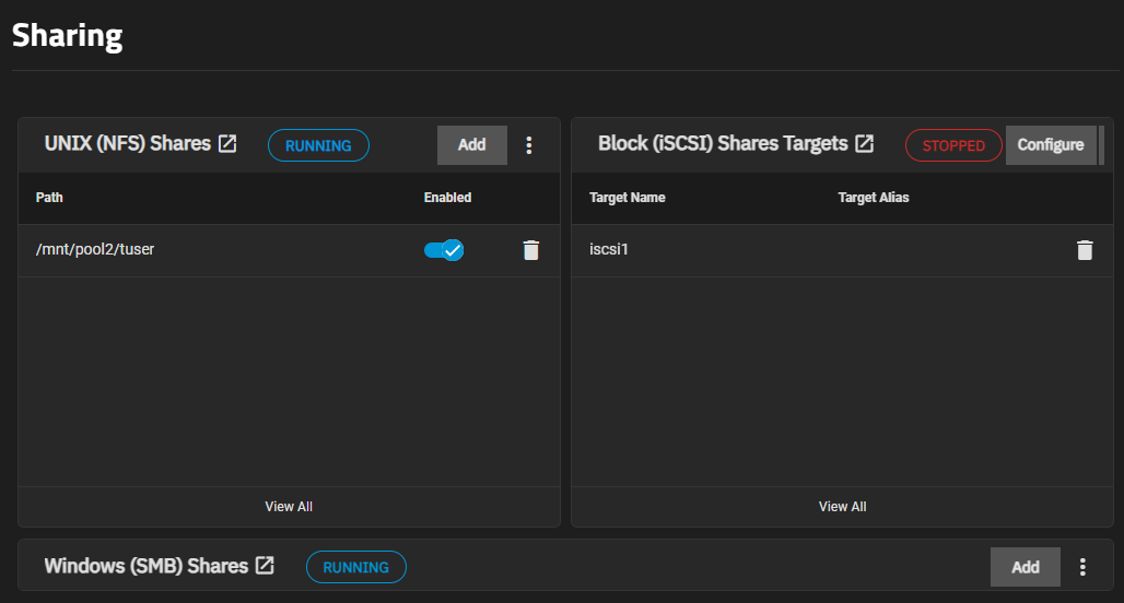

The more_vert on the toolbar displays options to turn the iSCSI service on or off. Turn Off Service displays if the service is running. Otherwise, Turn On Service displays. The Config Service option opens the configuration tabs Target Global Configuration screen.
If you have other share types added to your TrueNAS system, the widget displays as a card on the Sharing screen.
SharingScreenWithiSCSIShareAdded
View Details also opens the iSCSI configuration tabs. Each tab includes details on the block shares added to the system.

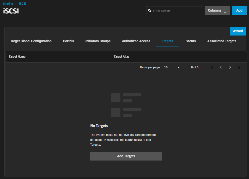

Targets Screen
The Targets screen displays settings to create new TrueNAS storage resources or edit existing ones in the list.
SharingiSCSITargetsScreen
Add opens the Add iSCSI Targets screen.
The next to each entry displays two options, Edit and Delete. Edit opens the Edit iSCSI Targets screen, and Delete opens a dialog to delete the select target. The Add iSCSI Targets and Edit iSCSI Targets screens display the same settings.
Add and Edit iSCSI Target Screens
The Add iSCSI Target and Edit iSCSI Target screens display the same settings, but the current settings populate the Edit iSCSI Target screen settings for the selected share.
To access the Add iSCSI Target screen from the Sharing > iSCSI screen, while on the Targets tab, click Add at the top of the screen. To access the Edit iSCSI Target screen from the Sharing > iSCSI screen, while on the Targets tab, click next to the share and then click Edit.
