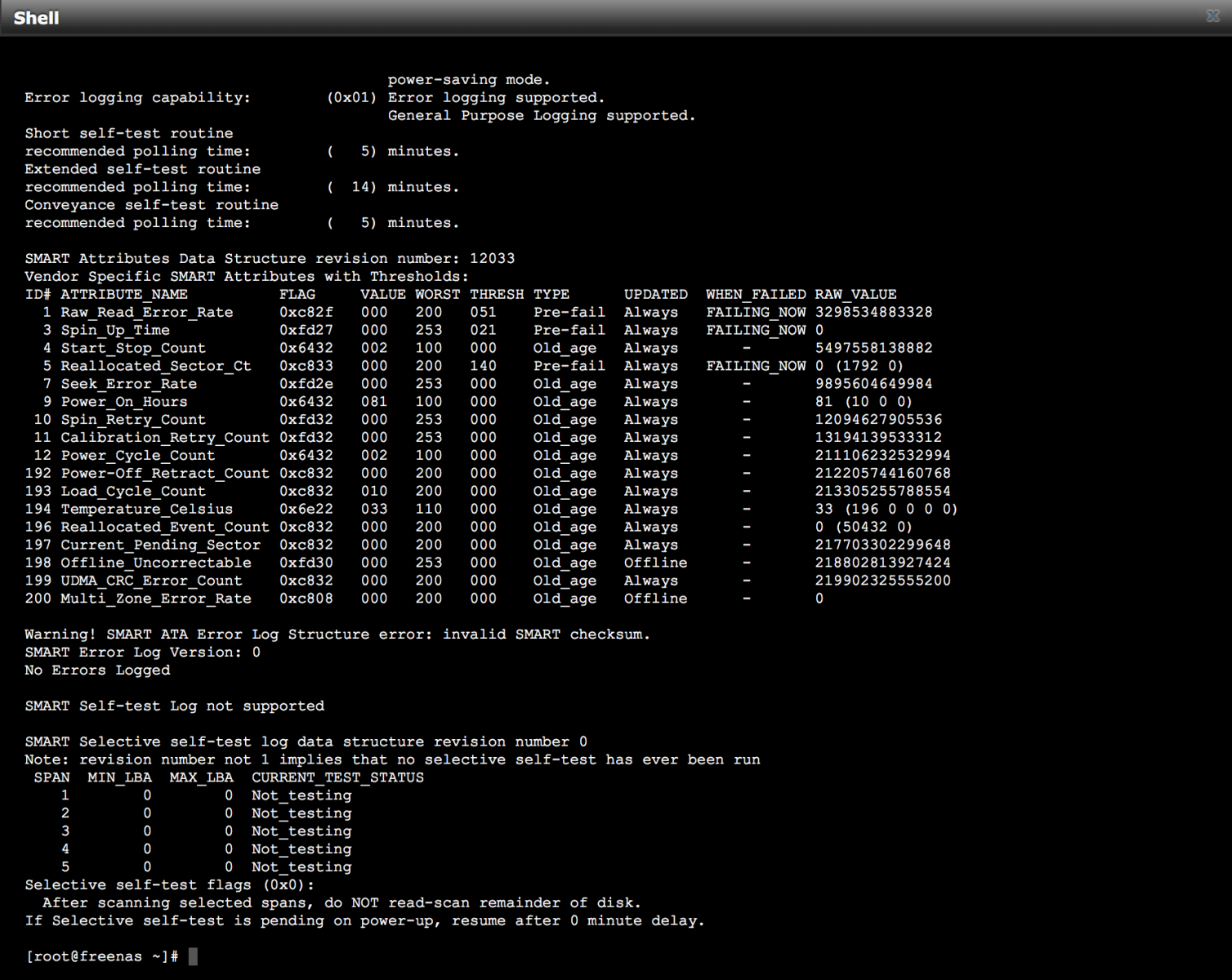

So I'd been getting some SMART errors for one of my disks a while ago, I have mirrored disks & bittorrent sync to 2 PC's for important files, so I decided just to monitor it - nothing really happened for several months until last weekend when my 2nd HDD failed aSMART test.
I decided to replace both drives (approx 18 months old 2TB WD Greens) on Monday, but as soon as I replaced the first drive I got a SMART failure from the new disk, & have been continuing to get errors every time I reboot.
This message was generated by the smartd daemon running on:
host name: freenas
DNS domain: local
The following warning/error was logged by the smartd daemon:
Device: /dev/ada0, Failed SMART usage Attribute: 1 Raw_Read_Error_Rate.
I don't know if I can trust the results for a brand new drive, & I'm having trouble interpreting them,
if someone could at least point me in the right direction, that would be great :)
SMART Attributes Data Structure revision number: 12033
ID# ATTRIBUTE_NAME FLAG VALUE WORST THRESH TYPE UPDATED WHEN_FAILED RAW_VALUE
1 Raw_Read_Error_Rate 0xc82f 000 200 051 Pre-fail Always FAILING_NOW 3298534883328

I'm divided between cable issue (UDMA CRC errors are astronomical) or just plain messed-up HDD (nearly all values are crazy high).
Replace the SATA cable. If that doesn't work, try it in another computer. If it's not back to normal, RMA it. Test new drives on said alternative computer first.

That's a disk that is totally f......
I'd just RMA it right now to be honest. The firmware is clearly out to lunch on that drive.

Note that the insane raw values are actually ((SMART ID#in next line) << 40 + (real raw value?)). E.g. ID#12, Power Cycle Count, is 211,106,232,532,994. That's hex C00000000002, which is (192<<40) + 2. The next line has SMART ID# 192, and a power cycle count of 2 is reasonable. That probably rules out a cable issue. Probably explains the checksum error as well. So yeah, firmware is buggy, RMA it.
What kind of drive is this, BTW? That part scrolled off your screenshot.

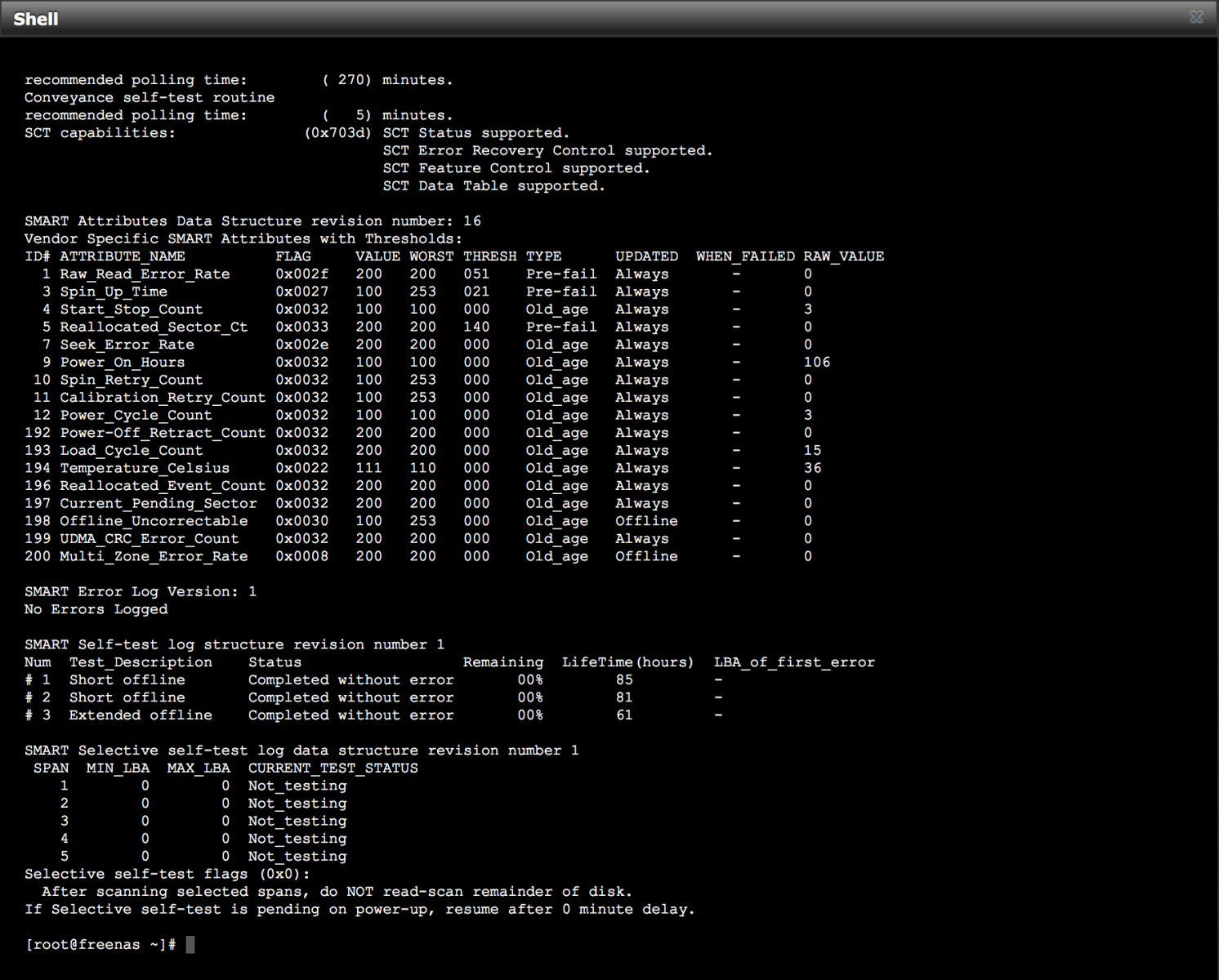

Thanks everyone,

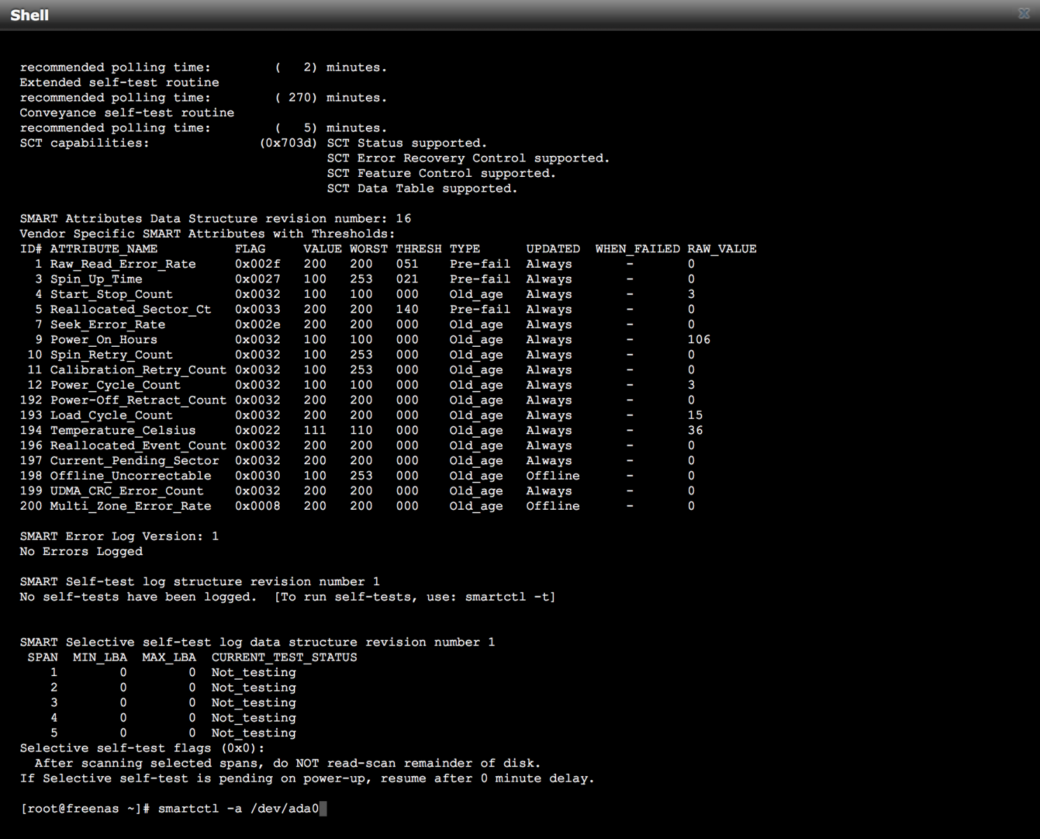

I had a go at replacing the SATA cable, I offlined the drive, formatted & resilvered the drive and ran a long test on the disk
I don't know if this is a weird issue - if I then run smartctl -a /dev/ada0 it returns "No self tests have been logged..." & if I issue the same command it returns a list of tests - see screenshots

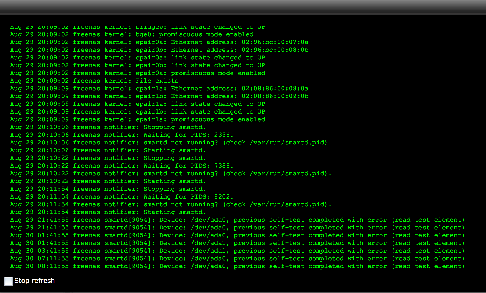

I'm still getting a "previous self-test completed with error (read test element)" output repeated, but none of those crazy values... yet

Ok, I'm really confused now, I've run more tests, & they've passed on both disks. However now Device: /dev/ada1, previous self-test completed with error (read test element) keeps being repeated in the console, plus 1 or 2 times about a servo/seek test element
